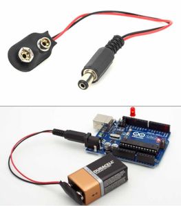

7) 9 volt batteryhttps://www.hepsiburada.com/varta-superlife-9v-pil-shrink-ambalaj-p-HBCV00000NQ35F?magaza=%C3%87TNGRUP
8) Barrel jack cable suitable for Arduinohttps://www.hepsiburada.com/elektronikport-9-v-pil-basligi-barrel-jack-arduino-uyumlu--p-HBCV00000FJDR2?magaza=Elektronikport

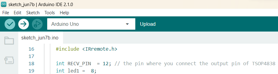

Open the Arduino IDE software, start new sketch and copy paste this code.
Step 3:
CONNECT your Arduino board to the laptop by the USB cable and click the uploading command in the software.

After uploading the code, you can disconnect from the laptop and connect the Arduino board to the battery.
