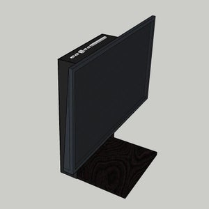

I used SketchUp to roughly model the PC, the used Fusion360 to make (mostly) accurate parts for 3D printing.
First I took 2 pieces of plywood and joined them in 'L' shape. This will be the main structure that will hold the 3D printed parts together and hold the weight of the monitor. The width of the plywood is a few centimeters larger than the laptop motherboard. The height is height of the motherboard plus height of the SSD and some.

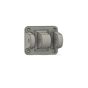

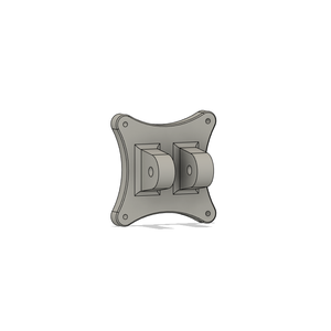

Then I modeled the vesa mount and the tilt adapter in Fusion360.

For the vesa mount and the adapter I used 7 perimeters, 4 top and bottom layers, 20% Rectilinear infill on the bottom portion and 40% Gyroid infill on the top.(Modifiers in Prusa Slicers)

To remove the old monitor stand I had to remove the whole back panel, just to remove 2 screws. After removing the stand and reattaching the back panel, I screwed in the vesa mount with M4 screws and some washers.
