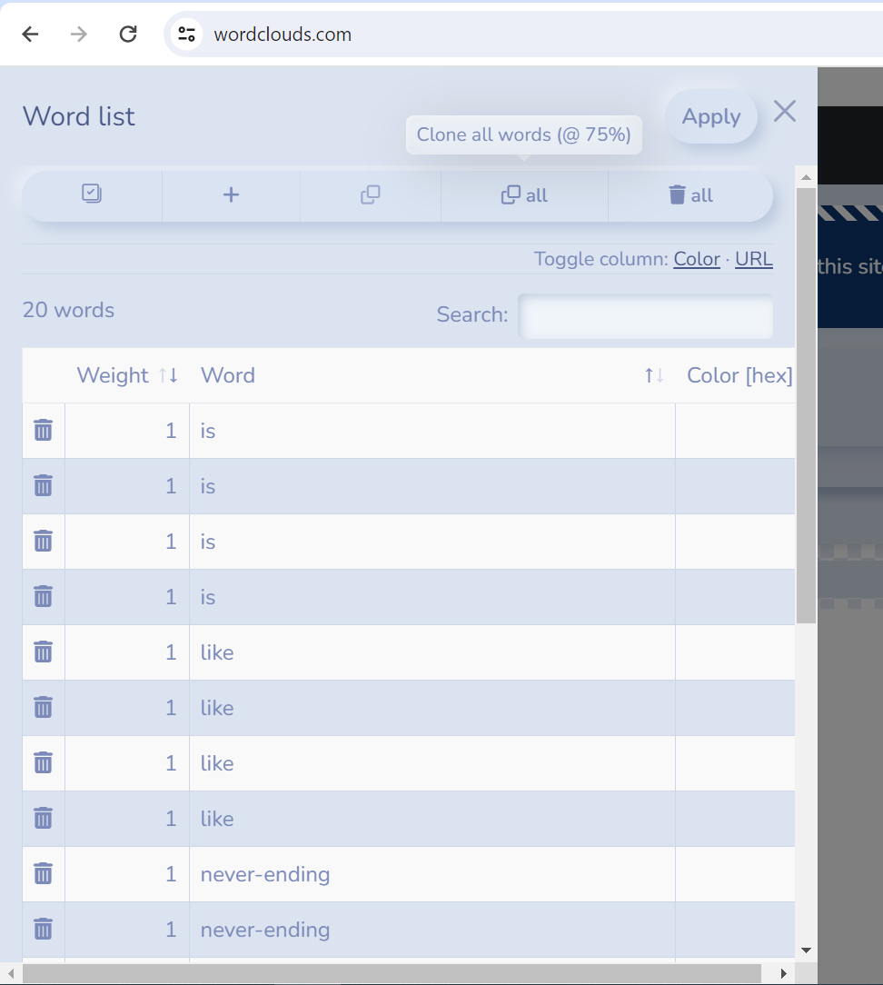

I go to wordclouds.com and do the following: Under File -> Wordcloud Background, I choose White. Then, under Wordlist -> Extract words from text, I paste my text, which then appears under Wordlist -> Edit. Here, I clone all the words twice, so each word appears four times.
Next, I choose a shape for the words to appear in. Under Shape - Select shape, I choose Square. For fonts, I select a few different typefaces, and under Direction, I choose Random for the placement of the words. For color, I choose a single color, Black. Now, when I click Randomize my message appears...
I repeat the rendering process until I'm satisfied with the result, and then I save the generated image.

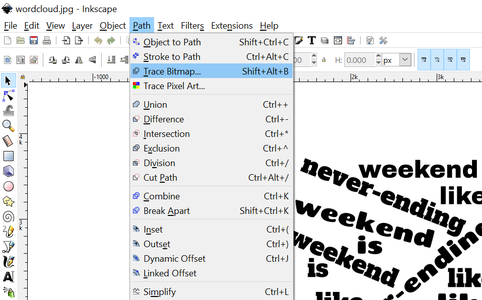

I loaded the image saved from wordclouds.com, selected it, and from the main menu, I went to Path -> Trace Bitmap. I didn't change anything in the window that appeared, just clicked the "Update" button. After an image of the message appeared in the small "preview" window, I clicked "OK" and closed the window. The vectorized message was automatically selected, but first, I moved it aside so I could select the original image to delete it. hen, I saved the vectors as an svg file. Look also at the screenshots above...
There are many tutorials online about vectorizing in Inkscape if you want to learn more.

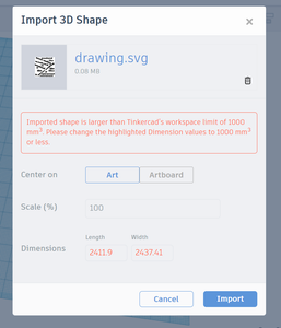

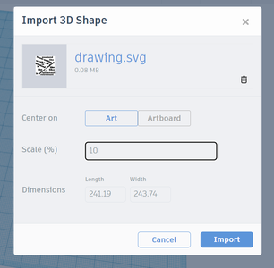

In a new 3D Tinkercad project, I imported the svg file created in the previous step. I was warned that the size of the vectors exceeded Tinkercad's maximum, so I reduced it to 10% and proceeded with the import. It was still a bit large, so while holding down "shift," I further reduced it to just under 150x150 mm. Then, I made it 1mm tall.
