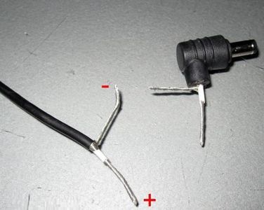

Step 2: Identify Charger Wires and Verify Polarity
Laptop chargers typically have two wires: positive (+) and negative (-).
If unsure, refer to your charger’s specifications or search online for your model’s wiring diagram.
Use a multimeter set to DC voltage to confirm which wire is positive and which is negative.
Carefully strip the insulation from the wire ends, exposing about 1 cm of wire for connection.
Double-check your polarity before proceeding to avoid damaging the charging module.
