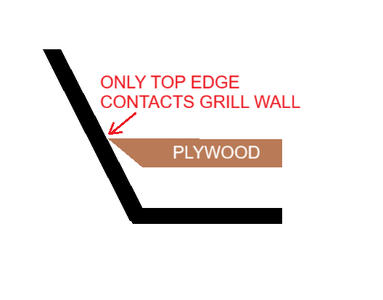

Step 2: Cut Plywood and Install in Bottom of Grill
Cut the plywood to fit into bottom of the grill cavity without any gaps. You may need to adjust the dimensions depending on slight variability in grills or if using a different grill. The grill cavity has 3 angled sides with the right-most side being nearly vertical.
The edges of the plywood for the angled sides is cut at an angle so just the top edge of the plywood contacts the grill cavity wall. I made these 3 edge cuts at about a 40 degree angle so that only the top surface of the plywood touches the wall of the grill. That way there won't be a gap for the shower curtain to sag into under the pressure of the water.

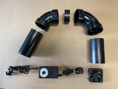

Step 5: Assemble and Install Fan
Fog, especially ultrasonic atomizer fog, needs air added in order to get it to flow out of the container it is located in. I always find a way to add an air source to bring air in to push the fog out. See my Fog Helper Instructable. This project uses an fan driven air pipe over the edge of the grill to add air.
I cut about an inch of black ABS drain pipe off to connect the elbows together. I then cut the remaining portion in to two pieces - one to connect to the fan and the other to extend the tube into the grill cavity. The pipe is press-fit together, no need to glue it.
The 60mm by 60mm fan perfectly lines up with the end of the 2-inch diameter ABS pipe. I hot glued the fan onto the pipe and spliced the power supply output wires onto the fan wires taking care to match polarity; positive to positive, negative to negative.
The fan assembly fits nicely over the edge of the grill cavity in the gap between the grill and the side shelf (when in the folded position).
The fan power supply fits down the same gap between the shelf and the grill. The variable nature of the power supply lets you adjust the fan speed to control the volume of air and the fog flowing over and out of the grill.

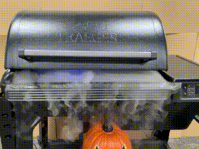

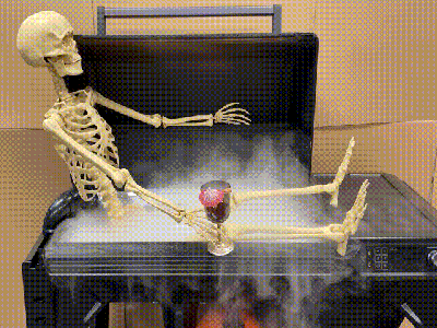

Step 8: Add Water and Decorations
I added water to just over the top of the black bulbous water level sensor on the atomizer. Make sure the water does not contact your taped edges. You don't want water flowing over the edge of your shower curtain.
You can experiment on what depth of water creates the greatest amount of fog.
I added a skeleton with a glass and fancy cocktail umbrella to the scene along with a large jack-o-lantern.
Step 9: Start Being Spooky
You are now ready to get spooky!!!! Fire the atomizer up and adjust the fan speed to get the amount of fog flowing that you like. You can even have the grill without the skeleton or even just partially open so spooky fog curls out.
