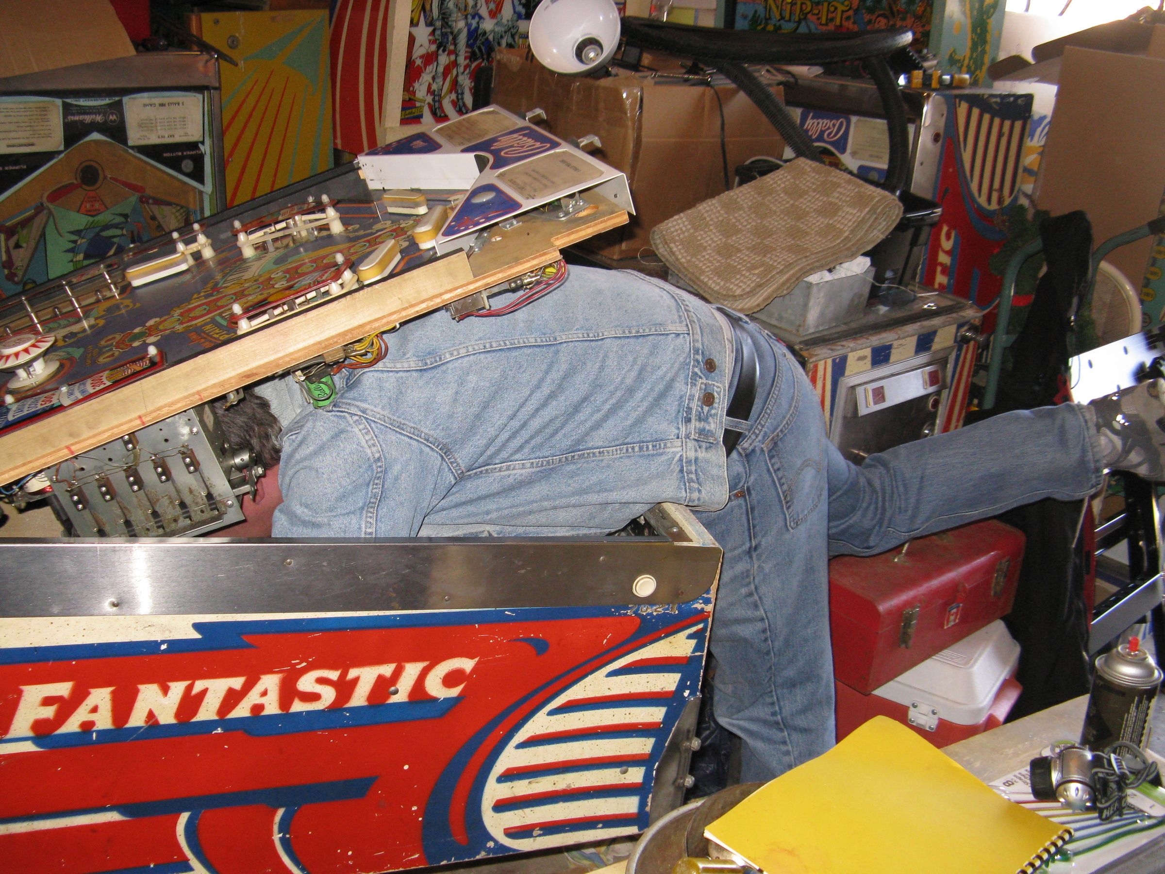

Step 2: Make Some Connections Inside the Pinball
The playfield and coin doors connect to the main insides of the pinball machine using rather large and old school connectors called jones plugs.  It is here where we will tap into the circuits to control the pin.
Rollovers, buttons and wire frames are all used to score features on the game. As the ball rolls over the switch above the playfield they will close a pair of contacts below.  Using your schematic and multimeter identify the pairs involved in the following:

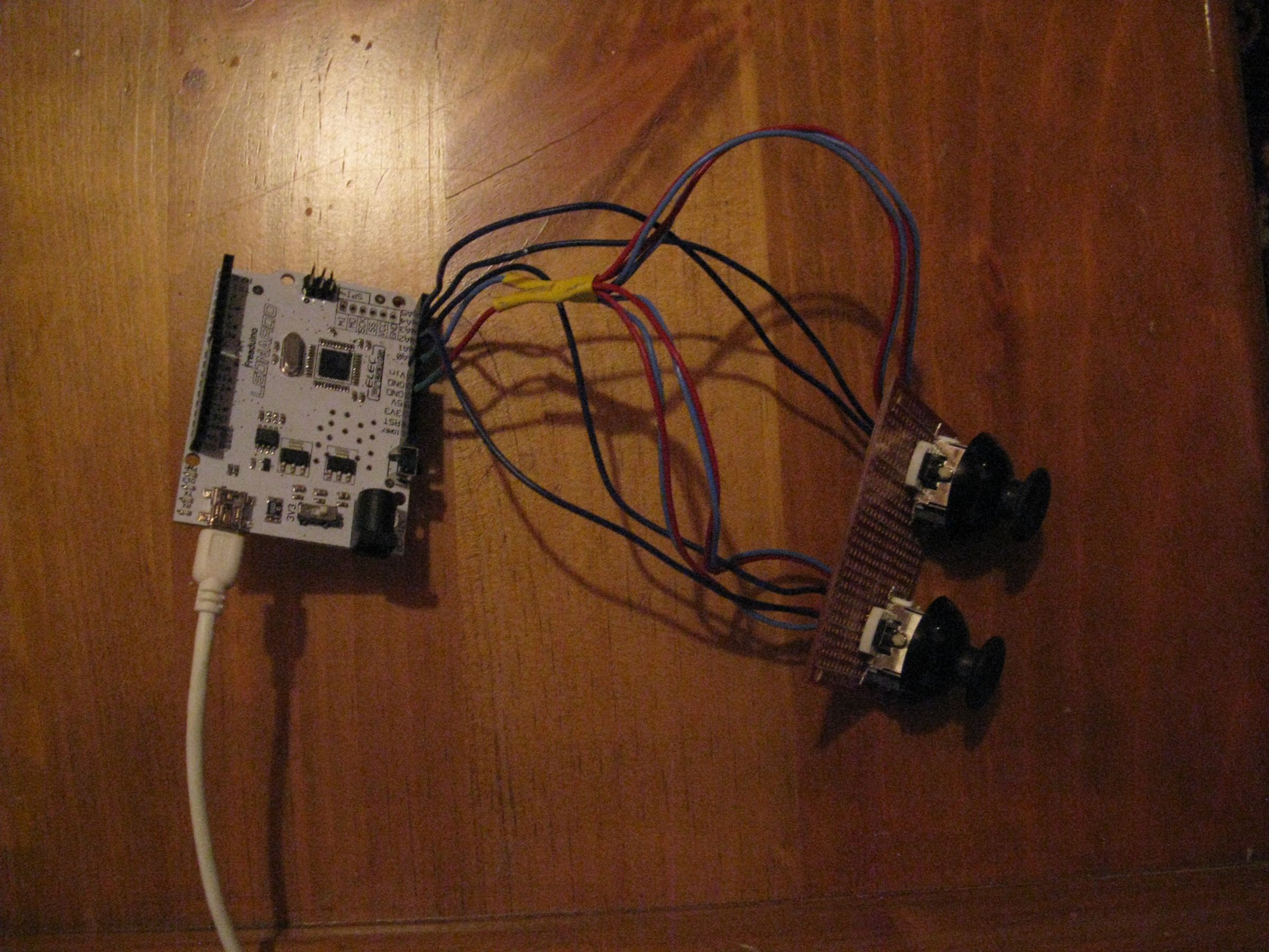

Step 4: Wire in the GPS
There are only three wires we care about on the GPS
TX (transmit data), this will connect to pin 0 (RX) on the Arduino
Ground, this connects to any ground on the Arduino
Power, we draw 3.3 volts from Arduino to power the GPS.
I built a couple small interfaces to the GPS, the one I ended up using was an old connector used in the days of  5 1/4" floppy drives. It  seemed to have the pins in the right spot.  I simply cut away the parts I didn't need and soldered on my wires.
Prior to this I made my own connector. To do so I cut a small piece of plastic to snugly fit the width of the slot in the GPS. Drilled a couple of holes right where the connection needed to be,. Inserted three pins that had wires attatched into the holes and wedged it all in.  Once in place it seemed quite secure but it did not hold up well to repeated insertions and removals.
Using either method I then wired the three wires into an female RJ45 coupler I had kicking around.  I rewired a similar rj45 coupler for the Arduino end, but here I just go from RJ45 t othree wires that end in pins that plug into the Ardiuno.
The reason I used the rj45 couplers was so I could use a standard category 5 ethernet cable between the Arduino and the GPS. I happened to have a spare, lengthy, cable from the days before routers at home all went wireless.

The connections on the Arduino are
pin 0 - TX from the GPS
pins 3,4,5,6,7,8,9 - These connect straight across from the Arduino to the relay board/shield. Please note that you cannot use 2.54 mm spaced header as there is a gap on the Arduino between pins 7 and 8 and it just won't fit nice.
  pin 3 goes to relay 8
  pin 4 to relay 7
  pin 5 to relay 6
  pin 6 to relay 5
  pin 7 to relay 4
  pin 8 to relay 3
  pin 9 to relay 2
  pin 10 would have gone to relay 1 - but I blew that relay up on the first day (best to pay heed to the disclaimers)
  pin 11 to select button
  pin 12 to advance button
gnd - A connection to ground on the Arduino board is required to each of the two buttons and the GPS
5 volts - to vcc on the relay board
3.3 volts to power on the GPS
Power to the Arduino is +12 volts from a PC power supply
Power to the relay board is +5 volts from the PC power supply
At this point I jammed the whole mess into a small box I picked up at the dollar store.  Had I been more patient I am sure I could have found a similar box filled with crap at the dollar store for the same price - but I opted for an empty one.  The biggest reason for the box - to stop me from dropping my Arduino on top of any stray volts or wires.
The buttons that I haven't talked much about yet are just simple push buttons that release when you let go of them.  one wire goes to ground, the other to the pin on the Arduino.  I use the Arduinos built in pull up resistors so no extra parts required.
The 8-relay board had a jumper I disconnected so I could use external power.  I tap 5 volts from the Arduino to VCC on the relay board and power the relay board with separate +5 and ground from an old computer power supply. The same supply I get 12 volts from to run the Arduino.
