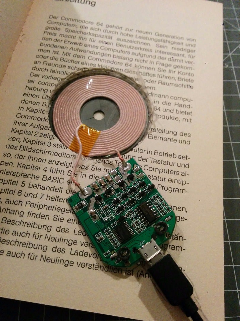

Decide where to place the coil and the pcb. The coil is usually centered under your phone or tablet, so you probably wouldn't want to place it to close to the edges. The book I used for this build was rather small so I decided to put the coil in the very center.
The pcb can be placed anywhere nearby. You can place it near an edge with the USB jack being accessible from the outside. I opted for embedding the USB plug into the book along with the pcb as I plan to use it on my desk having it plugged in all the time anyway.

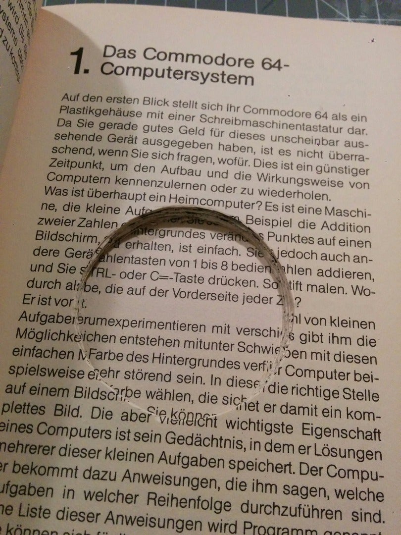

For maximum power transmission you want as little space as possible between the coil and your phone. For that reason start cutting the pages from the top.
I left a couple of pages untouched to have the option of sealing the coil and pcb. This is up to you.
Start by cutting the circle for the coil. I used a spray can which happened to be slightly bigger than the coil as a guide for the blade. Use a sharp blade and go slowly. Every so often check if you have removed enough pages.
Repeat the same procedure to create some space for the pcb. I cut the cavity for the USB plug in a separate step which is not necessary I guess. However the plug is much thicker than the pcb and goes down to the back cover of the book I used.

Insert the electronics, plug it in and close the cover. If you plan to use it mostly on your desk I don't think it's necessary to fixate the electronics. Place your mobile or tablet on it and watch with awe.
