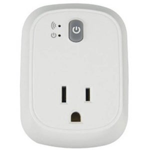

- WorkChoice 1 Ol Wi-Fi Indoor Switch (These go by a few different names EccoPlug and others)
- some wire. I use telephone wire from the dollar store
- hot glue. I glue after every solder to insure that the wire stays

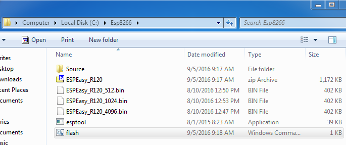

Download ESP Easy (Current version is 120 at the time of this Instructable)
ESP Easy firmware Mainpage for ESP Easy is here in case link is broken.
Unzip the contents. I recommenced using c:\Esp8266
Edit the flash.cmd file to direct the script to your current directory. (line 7 in code below)

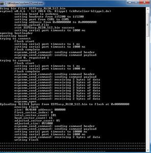

Plug the USB serial adapter into your newly wired header. Make that the VCC and GRN match. Once pluged your PC will assign the adapter a port. Make note of this port for the flashing procedure. Port 5 in my case.

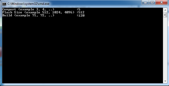

Double click the Flash.cmd file to start the flashing procedure. Type in:
- your port number (5 in my case)
- Flash Size: 512
- Build: 120 (as of the date of this post)
If all goes well, the serial adapter and ESP will start to blink as the firmware is being flashed to the ESP.

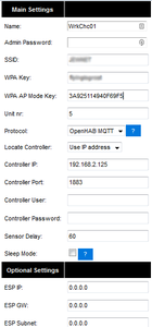

Step 3: Setup ESP Easy and OpenHab
Follow the Easy Setup Wizard instructions to get your ESP connected to your network.
I've included a shot of my setup that goes with my previous tutorials.
RECOMMENDATION! Change the "WPA AP Mode Key" to a complex password. If you don't and your ESP looses connectivity to your network, it will create the default network and open up to anyone within range. I pull my random passwords from GRC's Ultra High Security Password Generator.
