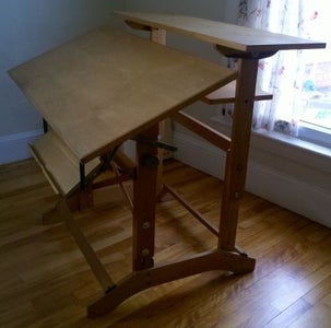

Step 1: Evaluate the Table
This table was found on Craigslist, and was chosen due to the massive potential seen in it. The seller said it may have originally been from IKEA. Regardless, it has several pros and cons:
Pro: Height adjustable,
Con: ...but this takes a little effort.
A bigger spender can use these modifications with an electric table.
Pro: Angle adjustable,
Con: ...but not for the second tier.
The main table adjusts beautifully, with sturdy manual knobs on each side. The second tier was designed to be angle adjusted, but the hardware does not support that task. This shelf will be replaced with functional hardware.

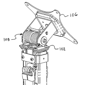

Step 3: Prep the Brackets

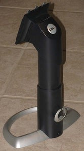

Flat panel monitor brackets can be modified to fit a variety of applications. For our purposes here, they will be incorporated into the design of an infinitely angle adjustable planar surface, or drafting table. The benefits of using this hardware are immense: they only require the setting of tension, and therefore they may be adjusted to any position with maximum convenience to the user.
Monitor brackets can be acquired from eBay, Craigslist, or your local office. The current low prices of used monitor stands (on eBay, for instance) reflect their perceived lack of utility.
Look for a monitor stand which does three things: rotates, tilts, and swivels. Some stands perform only one or two of these functions. Of course, this application only requires the tilt function, but who knows what you will be building in the future? This hardware is so versatile!
The Dell 1703fpt stand is preferred due to its all metal construction. It is very likely that many makes and models are similarly manufactured to satisfy a wide variety of applications. This, however, is an unknown. Go forth and experiment!

Again, the Dell 1703fpt stands are superior because of all metal construction. The Dell 1901fp stands are good, but the large washer is plastic which is inferior to the 1703fpt's metal washer. The design of the plastic washer necessitates replacement of the proprietary 2-1/4" bolt and its nut with standard ones.
