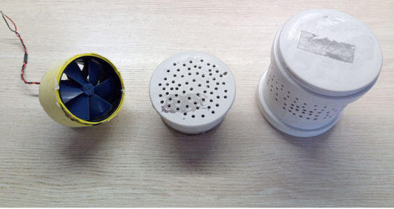

Step 1: Drill, Fit, and Mount the Fan Unit
🛠️ Instructions:
  1. Drill small holes around the side walls of the pipe and on the front cap (a 2.5–3 mm drill bit works well).
  2. Disassemble the hair dryer and carefully extract the fan motor.
  3. Wrap EVA foam around the perimeter of the fan housing until it fits snugly inside the PVC cap.
  4. Use strong adhesive to bond the EVA foam to the inside walls of the cap.
  5. Ensure the fan blades spin freely and remain well-centered.
  6. Keep the motor wires exposed and ready for connection to the power supply.
  7. Test fit all components before applying any glue. The fan should direct airflow through the filter and out the top.
  8. Optionally, sand the PVC edges to remove burrs and improve adhesive bonding.
Step 2: Install the Filter Inside the Perforated Housing
🛠️ Instructions:
  1. Drill multiple small holes all around the side walls of the PVC pipe using a 2.5–3 mm drill bit. These holes will allow air to enter the filter chamber.
  2. Cut an EVA foam sheet to fit the inner diameter of the pipe. You can wrap it into a cylindrical shape or use a pre-cut circular disk.
  3. Insert the EVA foam filter inside the pipe and press it into position. It should stay snug and not block the airflow.
  4. Ensure that the filter surface faces the intake holes and that air can pass through it freely.
  5. Optionally, use a small mesh or second filter layer to improve filtration.
NOTE:At the time I was designing and documenting this project, I did not yet have the HEPA filter. To keep building and test the airflow, I used a piece of felt as a temporary filter. While it doesn’t match the filtration efficiency of a true HEPA filter, felt is better than open foam for catching large dust particles and allows for early-stage testing of airflow and structure
