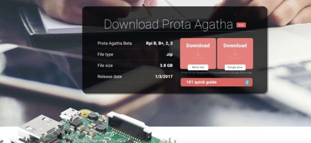

You can download Prota OS here. Then burn it on the SD card.
We made an easy guide you can follow to set up your Prota Pi.

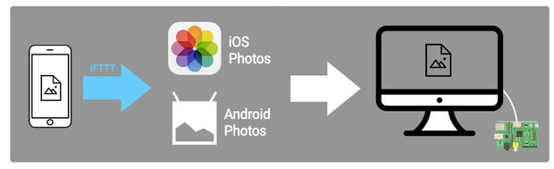

Automation of images directly appearing after you take them
- Click on +
- Click on When
- Set up the sensor-story as “When [IFTTT] runs a Prota applet...”
- Set up the action-story as “... [KIOSK SCREEN] add a new slide” and set the instructions as follow ⇒ set the value as Result1, the type as Image, set Temporary as True and the duration as 60 seconds.
Follow the screenshot below or this link.
