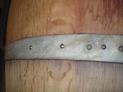

Step 4: Securing the Wood Staves
Before you can cut any of the wood staves, you need to secure them to the metal rings. The way that the barrel is constructed, if you remove a portion of the vertical boards (staves) the pieces above and below the opening will fall out.
I secured this wood by drilling two different holes through the metal ring and underlying wood. I used #8 3/4" stainless screws. The hole through the metal was just large enough to allow the screw through but I drilled the wood with a smaller bit to just create a pilot hole to prevent the wood from splitting.
I placed a screw above and below each wood stave that was being removed. I did this process for both the door access and the opening to bring in and remove water at the bottom.

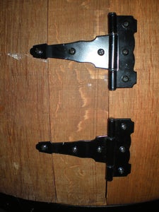

Step 10: Attach the Door Hinges and Hardware
You can use whatever you like to attach the door to the barrel.
Make sure that you choose something that will allow you to follow the slight curve of the door or are short enough to allow them to be straight.
First attach the hinges to the door.
Align the hinge to the outside of the barrel to allow the door to open freely.
(You may need to sand or slight trim the door or opening to allow the door to close/open easily.)
I placed a couple of door stops to help keep the door flush to the barrel when closed.
I chose to place a latch on the door (which is actually a window sash latch) but again, the type of hardware you use is totally up to you and the look you want.
