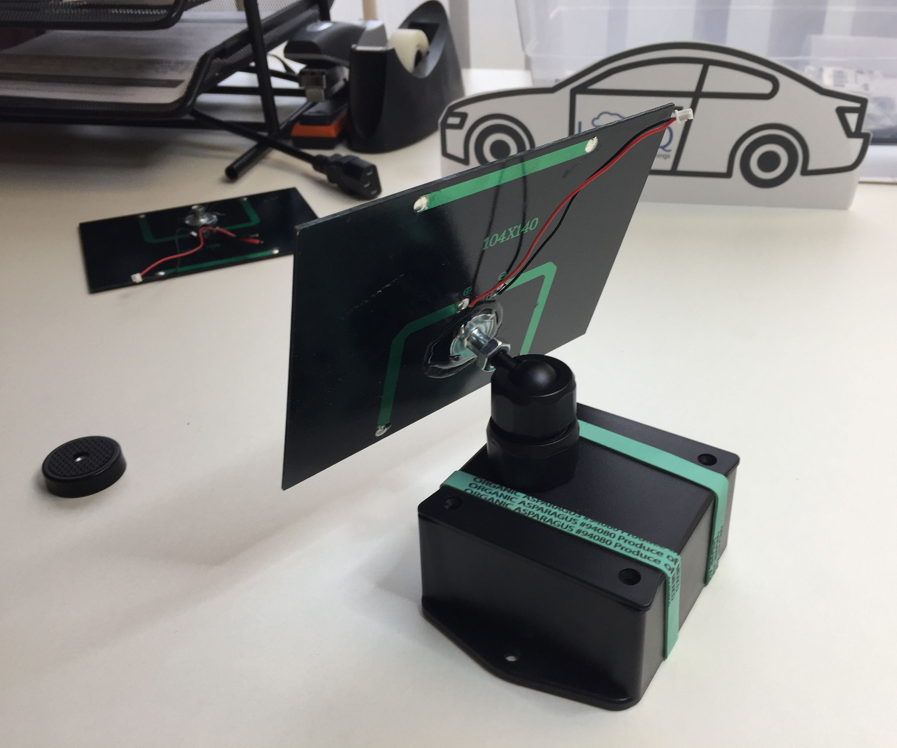

If you work with communications for a while, you will reach a point where you realize that if you could get an outside perspective that would really help your debugging efforts. That is what this project is all about, turning an Arduino into a LoRa radio packet sniffer. With this in your toolbox you will be able to see the traffic between two or more LoRa radio nodes, which will help you troubleshoot the applications your developing as they communicate across a LoRa network.
By example: while developing our LoRa Gateway product, we wanted to more easily examine the effects of different type of performance tuning changes. We could use traditional "programming" tools such as breakpoints or debug\print statements, but these techniques have side affects and alter the system being adjusted by their presence. By using a "network probe" or "packet sniffer" such as shown here, you can monitor the device communications without changing the software performing the communications. The packet sniffer approach has been used for years, this project is just an inexpensive approach to add to your toolkit with parts you might already own.
For the system I wish to test, I am using a Raspberry PI 3 running gateway software and an Adafruit Feather M0 with RFM95 LoRa Radio (900MHz for North America) as the "end-node" sensor device. As I make adjustments to the gateway or device software, the LoRa packet sniffer allows me to see timing (using millis()) and contents of LoRa packets traversing the network.
