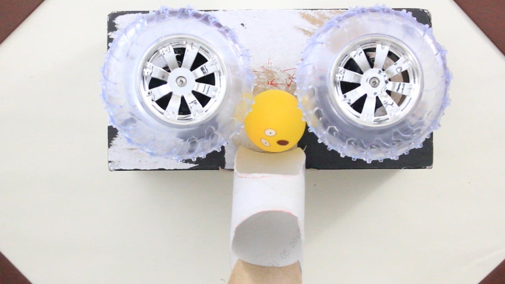

Step 3: Mounting the Motors
We need a platform to mount the motors side by side. To avoid the hassle of having to take time and fabricate something, I found a rectangular box that was perfect for the job. I measured the motors, gearbox, and wheels as well as the width of a standard ping-pong ball to determine the placement of the wheels. Then I cut holes in the box and mounted the motors in them. Now's a good time to test it and see if the measurements work. Just reconnect the battery pack to the mainboard, get the motors spinning using the remote, and see if you can launch some ping-pong balls! My rig ended up working perfectly!   At this point, we need to make a mechanism that can store the ping-pong balls. Paper towel or toilet paper tubes make a great way to funnel and store ping-pong balls. I just cut some to size and positioned them behind the middle of the motors so that they could funnel the ping-pong balls down through the wheels. Once they were positioned perfectly, I hot glued them into place.
From here, you should have a basic, functional ping-pong ball blaster. You can mount it to a tripod, or set it up on a table, and when you see someone passing by, use the remote to launch ping pong balls at them! It would be nice, however, if the blaster could automatically detect movement and start firing at whatever triggered it. If you think that'd be a nice addition too, then go on to the next step for a nice Arduino upgrade!

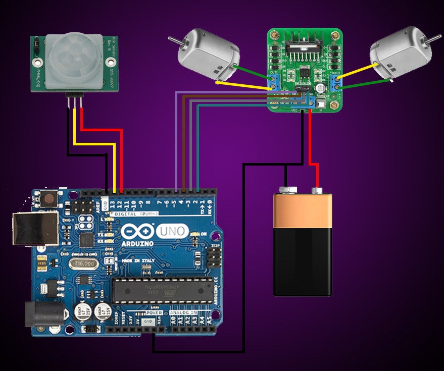

Step 4: Adding Motion Detection
Up until now, you should be able to make this entire project using what you've sourced from the RC car. But to take it to the next level, we can add an Arduino and a motion detector. To have the Arduino control the motors, we'll need to add some type of motor controller. You could use a series of resistors, diodes, and transistors, but I actually had an h-bridge dual motor controller that I'll be using. You can connect it to the motors, to an external power supply for the motors, and to the Arduino (pins 2-5). Take a look at the diagram below for details on how to connect it.
For detecting motion, I'm using a PIR (Passive Infrared) Motion Sensor. It has three pins, ground, a trigger pin, and a VCC (power) pin. I connected them to GND, 13, and 12 on the Arduino respectively. Again, refer to the diagram below for details.
To get the motion sensor working with the H-Bridge, we need to draft up some code and upload it to the Arduino. The code below is what I used for my project. Feel free to edit or tweak it to your liking.

Step 5: Testing It Out/Finishing Touches
Once the code is uploaded to the Arduino, test out the system to see if it works. If it does, the last thing you need to add is portable power. I used two 9v batteries, one for the motors, and one for the Arduino. I then stuffed all the components into the box, made sure it was all wired correctly, and cut a hole in the front of the box for the sensor. Loading in some ping-pong balls and powering it up, every time the sensor detected motion, it would shoot out ping-pong balls! Totally awesome! Remember to check out the video above to see it in action!
