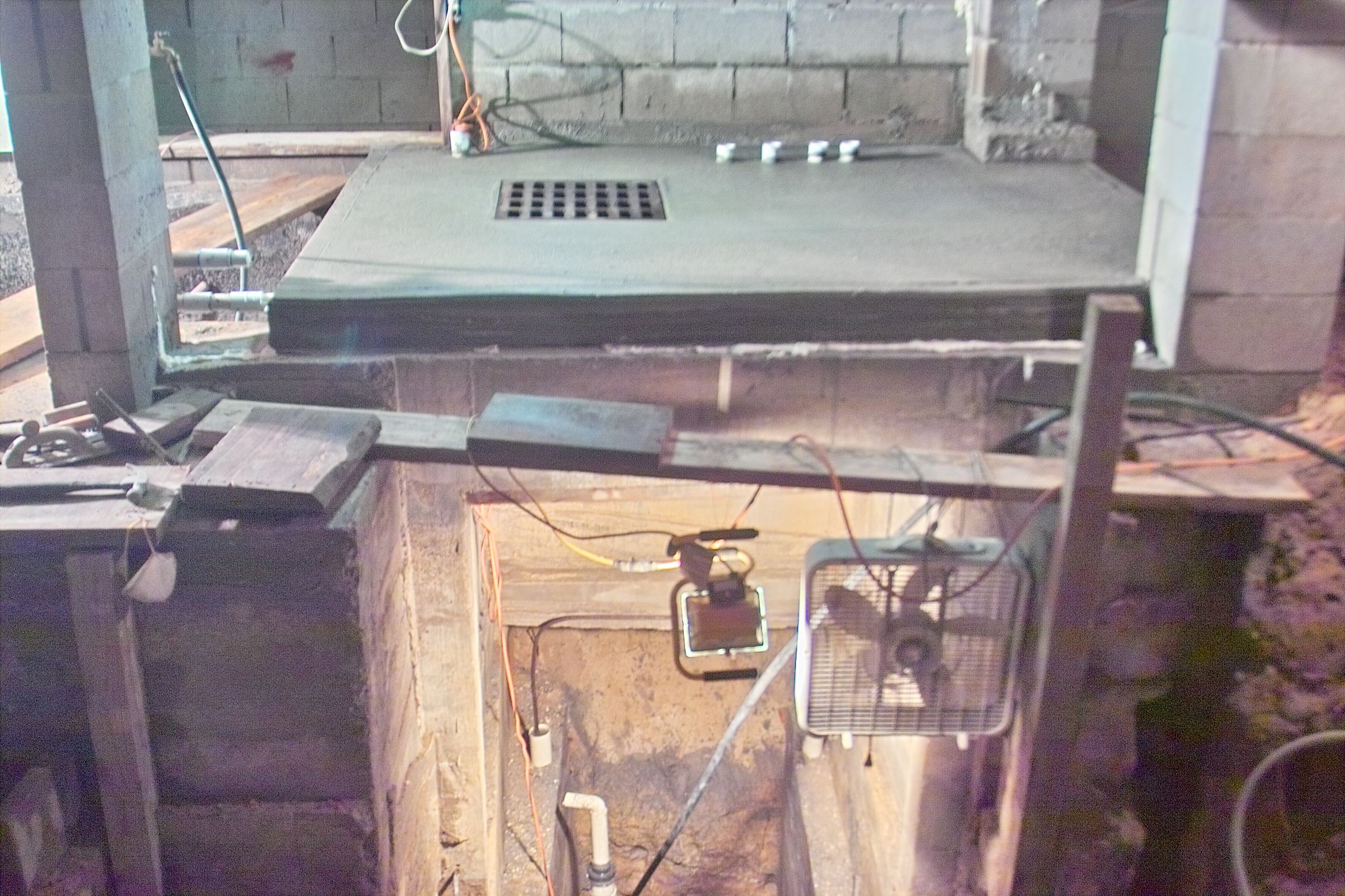

I began to experiment and after modifying a large tank I began to circulate hot water to try and warm the box of sand. After burning everything I could find, I began to realize that for the water to run in hot and back out hot and the sand to remain cool I was not transferring any heat.

I forgot to keep an eye on it and add water. When the water got low enough for it to start circulating steam instead of liquid, the pressure spiked and it made a very loud noise.
The sand was still cool...
