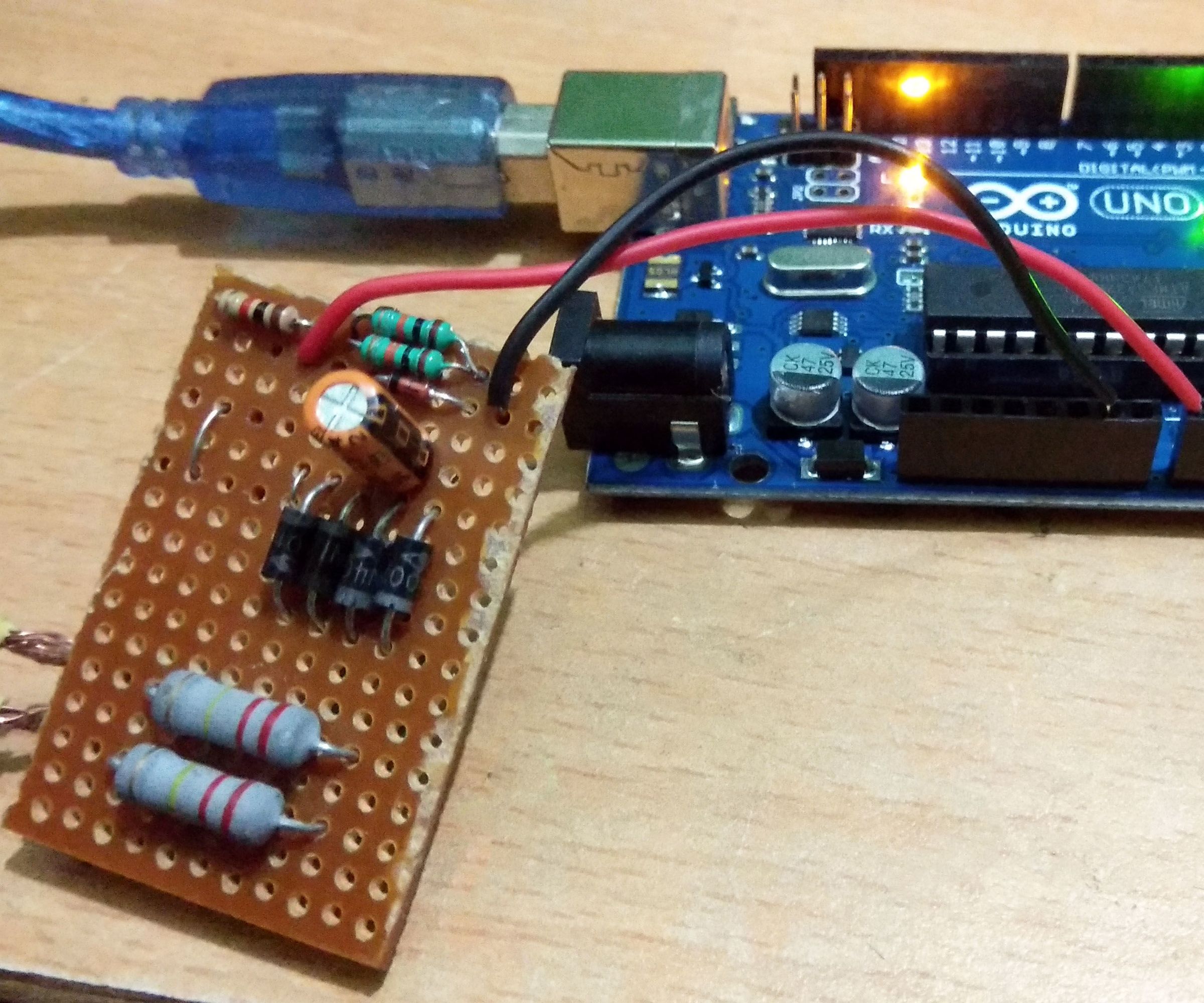

Connection
Connect RX pin of esp8266 to arduino pin 3 | NOTE :- esp8266 RX pin use 3.3v more than that will kill the module, use resistor as shown in diagram.
Connect TX pin of esp8266 to arduino pin 2
esp8266 vcc pin to 3.3v output of arduino
and ground to ground.
Connect led to pin 12 of arduino.
