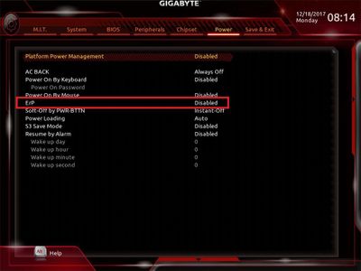

Step 4: Enable ERP From BIOS
Your PC may have ERP disabled, this prevents computer USB ports to turn off even when the computer is shut down. Thus you need to enable ERP from the BIOS setting of your pc. Check this video from Tech Mash for a better understanding: https://youtu.be/FlWKpgkNXKM
NB: this step is not required if you are using the USB port from your monitor or TV.
