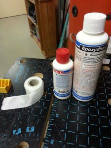

Also, I purchased some epoxy and some fiberglass woven tape for the sides. This was an experiment, because I have never used epoxy before.

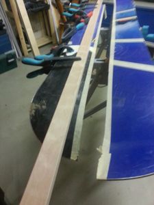

After the kit arrived and after reading the Instructions that came with it carefully, I went on to sawing my board. To be honest, I first felt a bit unwell with the vision of my poor board sawed to pieces. However, after some preparation, it went quite well. I marked the position of the bindings with tape, took them off the board, put tape through the middle so I can mark the center on it - otherwise it would be hard to write on a snowboard. Then I used a circular saw and a pile as guide (make sure it's straight one !). For the metal frame, I used a handsaw.
