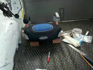

Clean out your space and find some objects you can sit on and things to represent a back rest so you know how your body fits in the fan. I used my daughter's booster seat and some bricks. I showed me not to put the rear seat too far back or I would bump my head on stuff. Get a basic idea on how you will fit and then its time to foam it out.

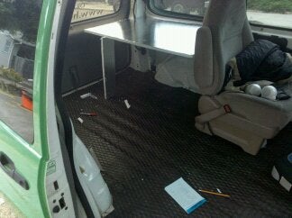

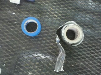

I bought about two four foot by eight foot by 3/4 inch foam insulation board from a home improvement center. You can cut it with a cheap bread knife I bought from IKEA (Guys, return and clean kitchen stuff each night if you are in a relationship). I also used foil tape (any kind will do) and kabob sticks to manage the foam. I started cutting seats, back rests, horizontal surfaces to meet the needs of my lounge. Try to make the fit close using a tape measure but remember, I will show a trick for a more precise cutting template. I wanted a love seat to sit with my honey and another seat across from the love seat so we can play cards as a family and so I can converse.
Step 3: Step Three
I actually went as far making the third seat before I had the idea making the third seat fold flat and the love seat backing to fold down for a bed. That's why foam is great, room for mistakes.
