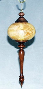

Turned wood ornaments can be a fun project that provide a decorative accent during the holidays or any time of the year. The techniques used to turn these little gems can be challenging to the beginner but also help build a variety of skills with very small pieces of wood. The ornament is basically a hollow wood sphere capped on either end by contrasting finials. Because they are made of wood, it is best to keep them small and thin walled to ensure they are light and easy to hang in a variety of ways. The choice of wood for the sphere and the finials is dependent upon your own tastes, but tiny finials can be a challenge with some open grain wood species. It may take some experimentation to arrive at the perfect choice for you.
I have made many different styles of ornaments over the years for sale and for family gifts. For this instructable, I will make a relatively simple ornament made of Maple with black walnut finials. The project typically requires about an hour for an experienced turner and up to a few hours for those just starting out. On a scale of difficulty from 1 to 10 where 10 is an advanced artistic hollow form, this project is a 5.

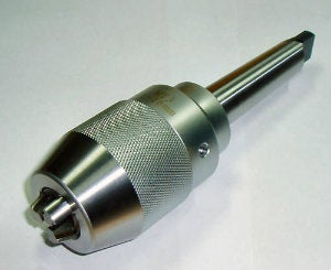

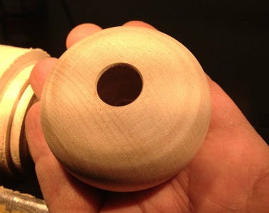

Once the shape is close to the final dimensions, we will drill a hole through the center. The center opening will allow for hollowing and placement of the finial and top cap. Mount the drill chuck in the tail stock of the lathe. Secure the ½ drill bit in the drill chuck. Set the lathe to a lower speed for the drilling operation. I suggest 300 rpms max. Drill the ½ hole through the ornament body and into the waste area beyond. We are now ready for the hollowing process.

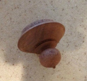

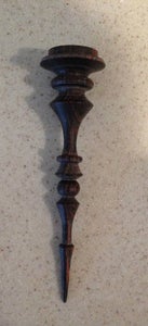

Each ornament will require a spindle and a cap. Before turning the spindle and cap we remove the chuck and set up the lathe for spindle turning. The wood must be wide enough for the the parts to cover the opening in the ornament and provide a nice decorative covering.
Mount the spindle between centers and rough the wood using the spindle roughing gouge until you have a clean round spindle.
Part the end of the long spindle piece that will cover the bottom ornament hole. This part must be the exact same size as the ornament hole. Measure with calipers for accuracy. After creating this part, begin shaping the spindle to your desired design. The thinner and more delicate the better! On the remaining section of the stock, turn a short cap for the top opening of the ornament. Complete each piece to the extent possible without completely parting the sections off. Sand the sections to 600 grit. Now, part the end of the spindle off. Cut the other part off as necessary.

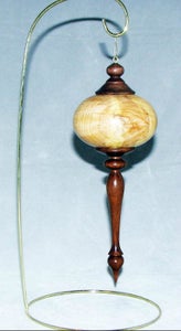

After sanding all the pieces, it's time to assemble. Using a small amount of CA glue (Superglue), attach the top and bottom to the ornament. Use the finish of choice to complete the ornament. Add an eyelet to the top cap and hang. Enjoy!
