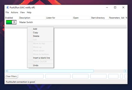

Step 4: Install Push2run for Turning Off the Pc

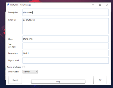

Install 'push2run' in the pc from push2run.com.

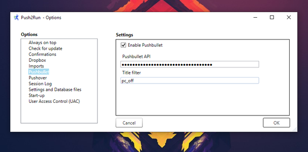

go to pushbullet.com and login > go to settings > accounts > then press create 'Access token' > copy it.
open push2run > select 'push2run' under options > select 'enable pushbullet' > paste the access token under 'pushbullet api' > enter the title filter > another window will pop up > right click and select 'add' > enter 'description', 'listen for', 'open', and 'parameters'.

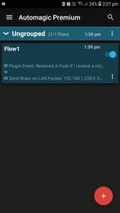

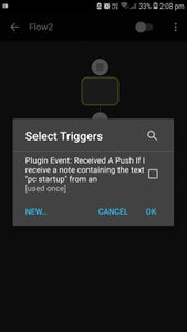

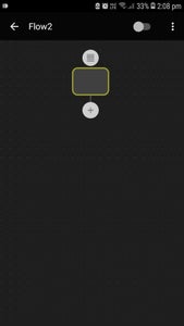

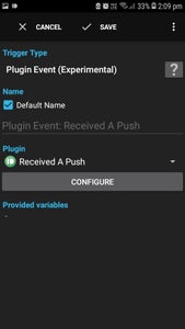

Install Automagic in your phone > open automagic > click on the plus icon > select the 5 lines icon > select 'new' > search and select 'Plugin Event (experimental)' > it will go to another page, select 'configure' > select "If I receive a note" > enter the text > select "from anyone" > select "then delete the push" > save everything.
Step 6: Action for the Phone App

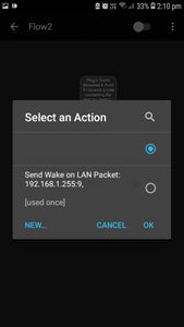

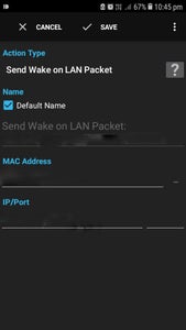

Click and drag the plus icon > select 'new' > search and select "send wake on LAN packet" > Enter the MAC address of your pc > for 'ip/port' enter your ip address with the last 3 digits being 255 for example 'aaa.bbb.ccc.255'

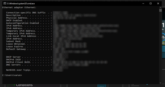

Step 7: MAC Address and Ip Address
Search 'cmd' and type in "ipconfig /all"
MAC address is listed as 'physical address' and ip address is listed as "IPv4 Address".
