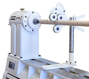

Step 4: Mount the Billet to the Lathe and Begin to Rough It Out
Now with the spur center able to grasp the billet you are going to want to mount your billet to your lathe. For my bat I positioned it so that the barrel is closest to the tailstock of the lathe but this does not affect the outcome of the bat, it just may be easier to follow the instructable if placed at the tailstock since I do so.
Once the billet is secured take your roughing gouge and start to take off just a little bit of the wood, removing at most about a quarter of an inch as that will leave you with just enough to make the bat of the barrel correctly. Do this over the entire length of the billet
