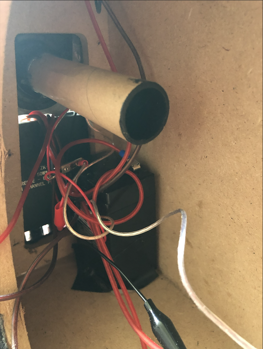

To connect the speakers to the board, I used insulated copper wire and looped it onto crimp connectors. I then connected each speaker to their respective ports (see chart). I then connected the board to an DC adapter in it’s power connection to make sure my system worked.
Step 2: Construction: Fitting and Powering
With an empty subwoofer box, we only have 2 accessible points: a hole for the amplifier and a hole for the woofer. To fit the speakers, I measured out two 4-inch circles on top of the box, and drilled them through to sit the speakers in. To power the speaker, I connected two 6V lead-acid batteries to each other to make a series. This way, they both operate as a single 12V supply and are rechargeable (I added an extra DC to alligator clip to the batteries to serve as a charging port). I can then connect that series to the amplifier’s DC connector (see chart). I tucked each battery into one side of the speaker and fit everything inside the casing. For the tweeters, I drilled extra holes just big enough for their wires to fit through so I could attach them to the top.
Step 3: Quality Modifications: Protection, Carrying, Airflow
For protection, I added a grill on top of each of the full range speakers, and reused the grill from the original subwoofer. The tweeters are sealed with soundproof tape, as well as the amplifier. To control the airflow being produced inside of the box (this is important for acoustics), I fitted a cardboard tube to a piece of recycled plastic and sealed that too with soundproof tape. For carrying, I attached four hook screws to the box, one in each top corner, and looped a long shoelace around to function as carrying straps.
Step 4: Finished Product
Once you put it all together, the inside of the speaker will look something like this. Lock the subwoofer in and your boombox is complete!
