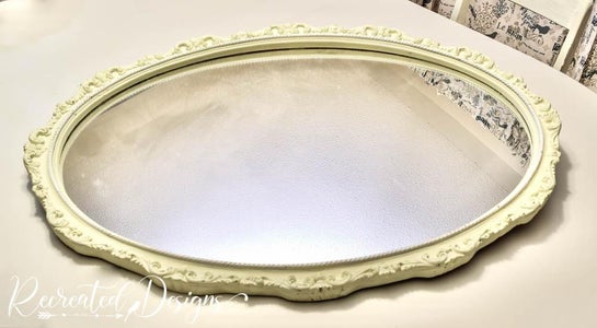

Step 1: Prep the Mirror
To get the mirror ready for the project, start with a good cleaning. The frame can be cleaned with soap and water and the mirror with glass cleaner.

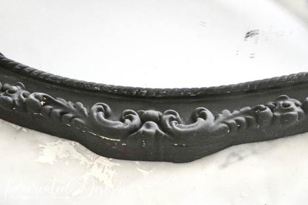

Step 2: Paint the Frame
The key to creating a gorgeous, old-world piece of art is layering. You want the details on the mirror to pop and look like an old gilded frame.
To start, paint the frame was painted with a chalky black paint. Annie Sloan’s Athenian Black is a great choice. The more matte the paint the better.
Make sure to push the paint into all of the little nooks and crannies, you want to make sure all of the frame is completely covered.

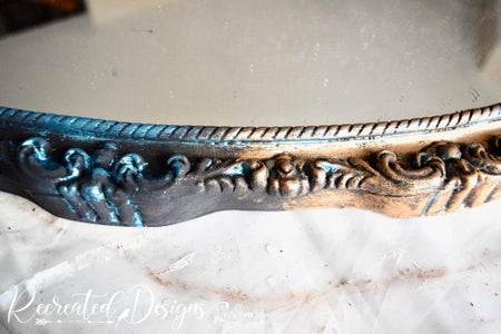

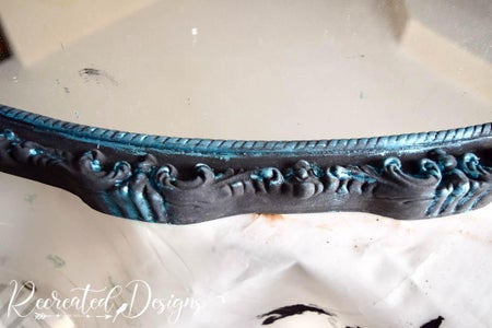

Step 3: Add Metallic Paint
Now that there was a good base, the layering begins.
Use a colour that compliments the picture you have chosen. I used metallic paint in Teal to highlight the teal in the paper I would be using.
To apply this layer, use a small detail brush and lightly brush the cream onto some of the high points and push it into some of the low points.

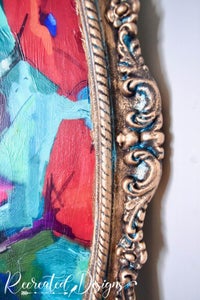

Step 4: Layer Metallic Paint
Next, use a larger brush to add silver or gold. Don’t worry about completely covering the frame. You want the other two layers (black and blue) to show through. Lightly brush the gold or silver over the tops of the details.

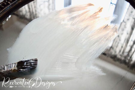

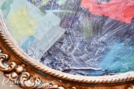

Step 5: Brush on Transfer Medium
With the mirror frame finished, it is time to add the picture to the middle. Start by brushing on a decoupage or image transfer medium all over the mirror. I used Annie Sloan Image Medium but you can use Mod Podge or any other transfer medium. Make sure the entire mirror is covered.

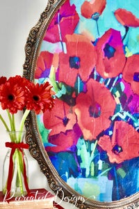

You don’t have to be an artist to create a stunning piece of art… you just have to find a picture you love!
I found some amazing decoupage papers from Mint by Michelle and chose this one called Poppies for my project. Its bright, beautiful colours are beautiful and cheery.

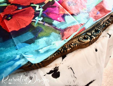

Step 7: Lay Down the Tissue Paper
Once the mirror is completely covered with the transfer medium, lightly lay your paper on top, positioning it where you want it.

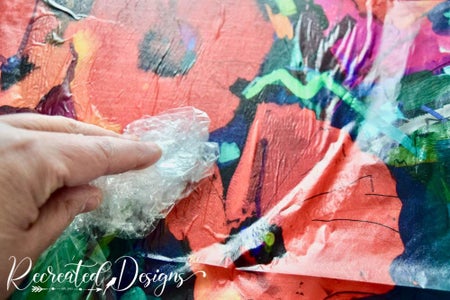

Step 8: Smooth Out the Tissue Paper
To smooth out the tissue image, use a piece of scrunched-up cling wrap. The plastic wrap will help to keep the paper from ripping.
There will be wrinkles in the paper with this method but personally, I love those as they give the piece texture and depth and make it look older.

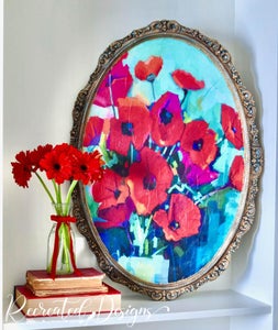

Step 11: Mixed Media Art
I am absolutely thrilled with how gorgeous the details on the frame are and how much the mirror looks like an old gilded frame now. You wouldn't even know that this was a $3 mirror that I picked up at a garage sale.
