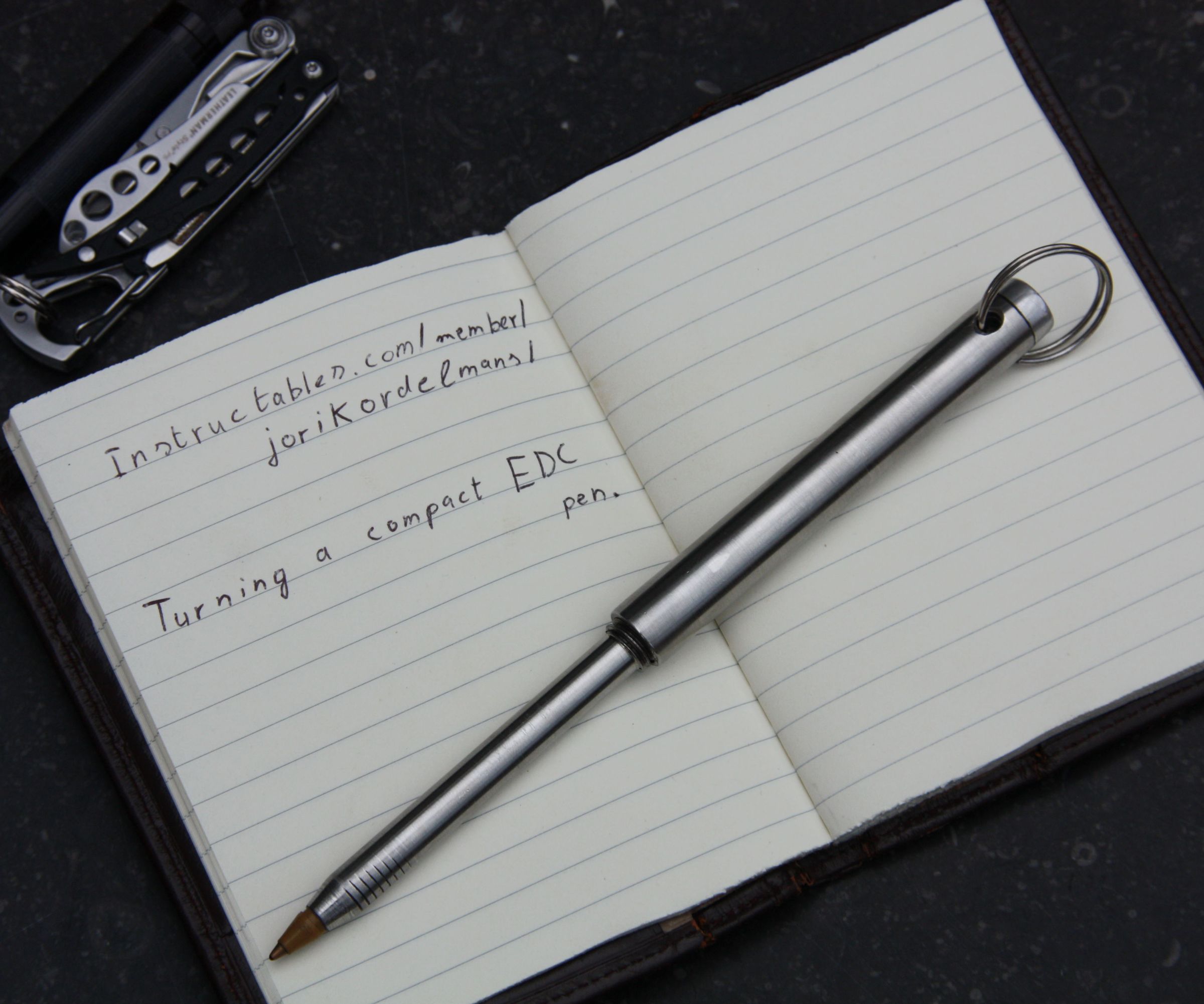

I started to carry a notebook with me all the time about 3 weeks ago and thusfar I used it every day. From grocerie lists to drawing on the train. The only thing that bothered me the most was carrying a fullsize pen or pencil with me all the time. I began to look into small EDC pens such as the Fischer Space Pen Bullit, but I was not going to pay 30 euro's for a pen.
So I decided to make my own compact EDC pen. This way I will even get more satisfaction using it and I save quite a bit of money.
I works quite good for me right now, but there are some changes I would make when I make another one. I will explain these in the last step. So make sure you read those before you start fabricating it.
Step 1: Design
The design I came up with is pretty easy to fabricate if you've a metal lathe available.I also tried to make it from materials that are widely available, cheap and relatively easy to machine.
Because of the long cap you get a fullsize pen, but when you close it it stays very compact. A key ring makes sure you can hang it with your other EDC items such as multitools and flashlights.

The assembly is really simple. You cut of your filling off, a little less than 75 mm and you push it inside of the pen. If your friction fit is not ideal you could use a little peace of scotch tape to wrap around the filling. The other thing that still needs to be done is pushing the key ring through the hole in the cap.
Step 6: You're Done
Your compact EDC pen is now completed.
But there are some things I would change if I make another one.
First of I woud make it a couple cm shorter. Now it made it that the total pen is over 15 cm long, but for a comfortable writing experience I would only need 12,5 cm. This change will make a lot of weight difference and will also make it even more compact. It would also take care of the top heaviness
Second I would try to make one with a M8 bolt and tap. This would also improve the weight a lot.
