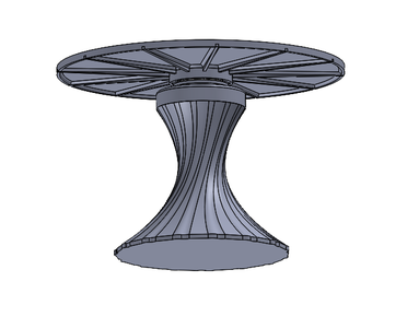

I redesigned some parts of the V1 that were defective:
  1. Made the base wider for more stability.
  2. Changed the main plate so it can be detached.
  3. Changed the base attachment from screws to a sliding interference fit.
I used a 3D printer, two thrust ball bearings (51104), and some Dupont silicone anti-slip mat.
