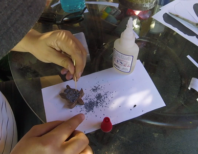

Step 4: Applying the Inlay.
So I picked up some crushed coral off of amazon and I already had a few pieces of mother of pearl. The coral came crushed so this was the easier inlay of the two. I added a drop of glue to the pockets and sprinkled the inlay over it. Then I used a toothpick to spread the coral around and push it into the voids. I repeated those steps until it was all filled.

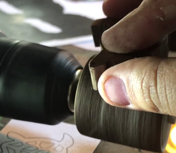

Step 5: Sanding & Finishing.
I put a spindle sanding attachment in my hand drill and used it to shape the turtle a little more. I then used to sand down the inlay and make it flush with the wood. This can take some time so just be patient.
