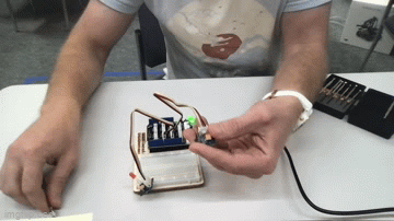

Step 3: Upload and Test
You'll need to upload this program to the Arduino (after saving it with an appropriate name into your Arduino Project Folder). Make sure you have gone to TOOLS / Serial Monitor, while in the Arduino IDE software and that a little white window popped up. Once you have uploaded the program to the Arduino, values should start appearing in this window. These are 'live' values of our light sensor data.
Note, in normal light, the values should be pretty high. As you move your hand over the light sensor and lower it, to block more and more light, note how the light values go down. We used 300 as a cut-off point. How much do you have to cover this for it to work? If the values are never going less than it, then maybe make the threshold higher (say 400 or 500 instead of 300). If the light is permanently on because even in full light it is less than 300, change it to some lower value. A trick is to note the value in normal conditions, and move into a dark place (or cover sensor with hand) and note the other value. You can make your threshold value somewhere between these 2 values.
