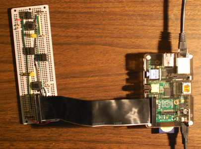

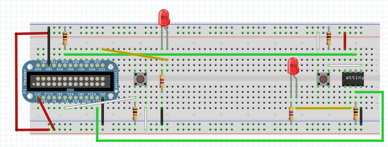

Step 1: Building the Circuit
To build the circuit you will need:
jumper wires
4 10K resistors (Pulldowns)
2 330-560 Ohm resistors (For LEDs)
2 small push button switches
2 LEDs
Attiny85 Microcontroller, available here: https://www.sparkfun.com/products/9378
Here are the Attiny85 Pinouts:
Reset 1 * 8 VCC 5 Volts
Analog In 3, PB3 2 7 PB2, Analog In 1, I2C SCL, SPI SCK
Analog In 2, PB4 3 6 PB1, PWM, SPI MISO
Ground 4 5 PB0, PWM, I2C SDA, SPI MOSIFollow the diagram above to build the circuit.
