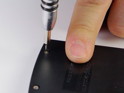

Step 1: Carefully Disassemble an Electronic Calculator

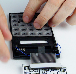

Step 2: Identify the Input Terminals of the Equal Button on the Digital Desktop Calculator.

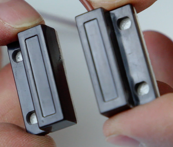

Step 3: Connecting the Magnetic Switch to the Digital Desktop Calculator Identify the Input Terminals of the Equal Button on the Digital Desktop Calculator.
Connect one wire from one pole of the magnetic switch to one pole of the equal button.
Connect The Other Wire Of The Magnetic Switch To The Other Pole Of The Equal Button.

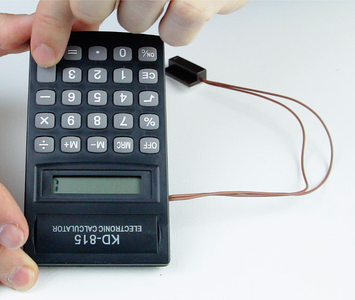

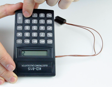

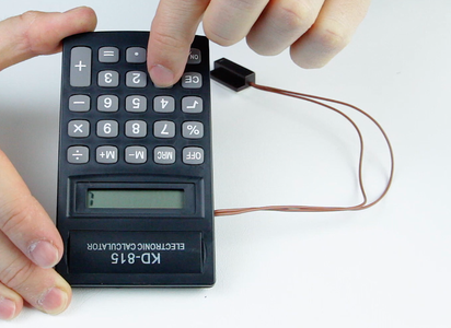

Step 4: Testing Functionality
 Press the button on the digital desktop calculator to initiate a new operation, such as adding 1 + 1. Approach the magnet to the magnetic switch. Observe how the digit displayed on the screen of the digital desktop calculator increases with each approach of the magnet and displays the correct result, 2 in this case.

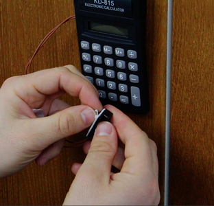

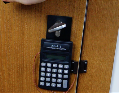

Step 5: Mounting the Magnetic Switch on the Door
Identify the suitable location for mounting the magnetic switch on the door. Ensure that the surface is clean and dry. Attach the magnetic switch to the door using adhesive or screws.

Monitoring door usage Once the device is installed and functional, it can be used to monitor how many times the door is opened. To identify the number of openings or who has entered and exited, observe the digits displayed on the digital desktop calculator and take notes or use a recording program if available.
