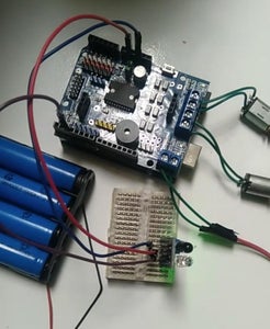

Quantity
Arduino Uno +USB = 1
L298P Motor Driver = 1
WAG Cable
Motor Mini MetalGear N20 = 2
Battery 12V

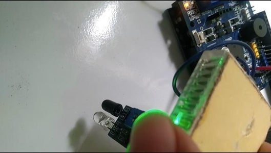

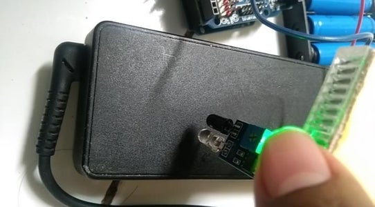

IR Sensor = 2
Step 1: Code
In this tutorial, you need to use this motor driver shield pins stacked on the Arduino Uno. Then, connect the two gear motor to the terminal block of MOTOR Right and MOTOR Left. IR Sensor Right Connect to pin 2 Arduino PWM dan IR Sensor Left to pin 3 Arduino PWM
