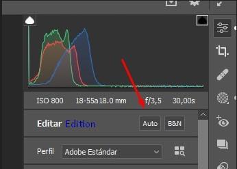

Quick Option: Auto Edit
Camera Raw includes an automatic editing function that can serve as a starting point:
  1. Look for the "Auto" button in the Basic panel (next to the Exposure controls)
  2. When clicked, the program analyzes your image and applies automatic adjustments
  3. Advantages: Can give you a solid base to continue editing manually
  4. Tip: Use "Auto" as inspiration and then customize values to your taste
  5. Not all automatic edits work equally well, but it's worth trying

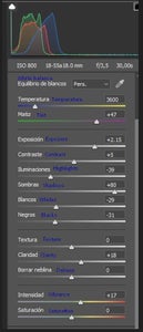

2. Basic Panel - Fundamental Adjustments
Temperature and Tint
  1. Adjust the white balance to get the color you like best
  2. More blue (low temperature 3000-3800K): cooler, more spatial look
  3. More purple/magenta (add tint toward magenta): purple tones in the Milky Way
  4. Recommendation: Try different combinations until you find your style
Exposure and Tones
Adjust these controls according to your specific image:
  1. Exposure: Increase if the photo came out dark (normally +0.5 to +1.5)
  2. Contrast: Add contrast to separate the Milky Way from the sky (+10 to +30)
  3. Highlights: Lower to recover details in bright areas (-20 to -50)
  4. Shadows: Raise to reveal details in the foreground (+30 to +70)
  5. Whites: Adjust the brightest stars (+10 to +30)
  6. Blacks: Intensify the deep sky (-10 to -30)
Trick: Hold down Alt/Option while moving Whites and Blacks to see clipping (blown/blocked areas).
Presence
  1. Texture: Increase to give more definition to the stars (+20 to +50)
  2. This control is key to making stars sharper and more defined
  3. Clarity: Add carefully for more punch (+10 to +25)
  4. Don't overdo it or halos will appear around stars
  5. Vibrance: Raise to enhance the subtle colors of the Milky Way (+20 to +40)
  6. Saturation: Adjust moderately to avoid over-saturation (+5 to +15)
  7. Better to use Vibrance than Saturation for more natural colors
