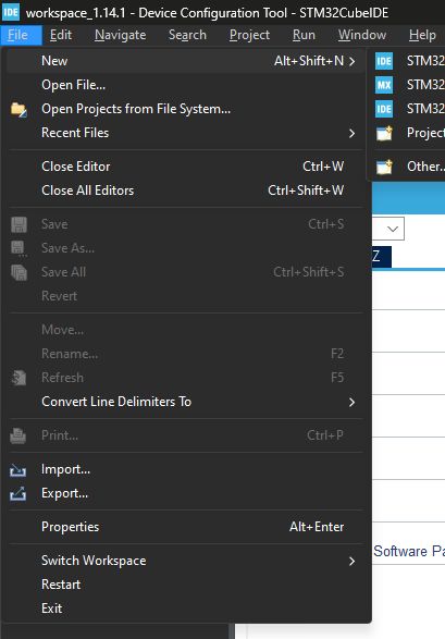

As we head into programming in the CUBE IDE head over to the top left and create a new STM32 project by clicking on "FILE" and then "NEW" then after on new "STM32 Project"

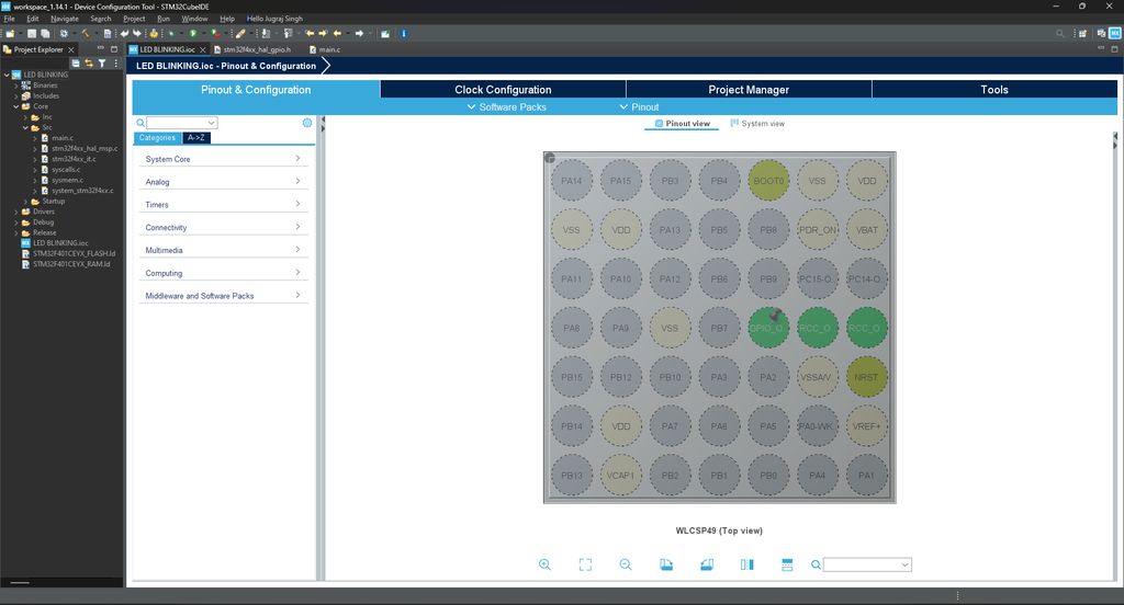

Step 3: Setting Pin Configuration
Once the file is created select the required STM board and then after set the pin configuration as shown.
(In this task we set the pin 13 as the required pin because in the STM board pin 13 is built in LED)

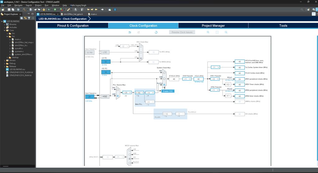

Step 4: Clock Configuration
In any synchronous circuit, clock frequency plays an integral part thereby we set the frequency as shown in order to execute the task.

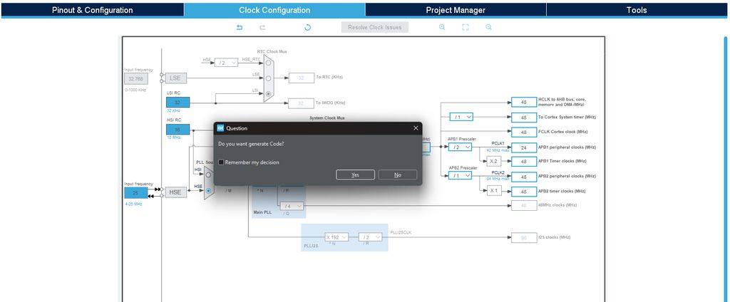

Step 5: Generating the Code
One of the major advantages of using STM32 IDE is that the code is automatically adjusted according the the clock configuration and then we just have to make a little bit of changes using the required syntax.

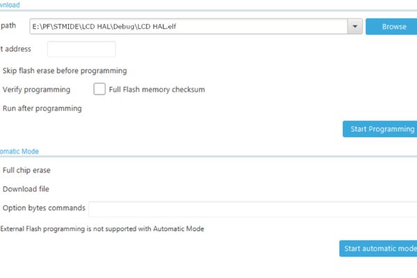

Step 6: Using the Binary File
One of the tricky part is that we will require the binary file i.e. .elf file.
For that, we simply open the .elf file created in the system explorer by Right clicking on the project and clicking on show in system explorer and copying the path on the STM32Cube PROGRAMMER.
