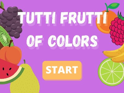

You need to make sure that the cables are touching the round foil buttons. Once you are set connect your Makey Makey to the computer and the game is almost ready to play!
Step 3: Playing the Game
Once you are ready, open the game in Scratch and ask the child to put the bracelet on. Press the Green Flag on the top left corner and hear the instructions. To start the game, the child will have to click on any color. An image of a color will appear and a small riddle (tip: tell the child to listen to the whole audio and then choose the color). If the selection is correct, then a small explanation of the color will be heard. If not, then a new clue or tip will be given to try again. The game ends once all the fruits have appeared.
