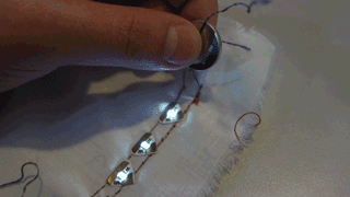

Recently, I was introduced to Chibitronics and their electronic stickers kit. They're fabulous, and they stick to fabrics well. Furthermore, the chibitronics pads are thin enough that they can be sewn through. Bunnie and Jie did a great job with their surface mount LEDs, so I was able to light up 5 of their LEDs in parallel with a single 3 Volt battery. I kept it at 3, however, because at this number of LEDs it was much brighter.

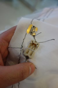

To embed them to the tutu, sew two circles near the hem of the lining with conductive thread in the bobbin. Make sure that they are not touching, or else it will short circuit! Mark one of the conductive stitches as positive, and the other as negative. Sew the LEDs on with more conductive thread.
I unfortunately forgot to take pics of the original design with just the battery holder attached to the LEDs, because I moved on and started making a sound reactive one... Just sew the coin cell holder, negative to negative and positive to positive, onto the conductive circles as well. Make sure they are not touching and short circuiting!
Because you only need to put conductive thread on the bobbin, I used a white thread as the top thread and made sure that I sewed with the tulle-side facing up. This helps keep the stitches slightly less visible. Because I used conductive thread to sew through the Chibitronics LED pads, I was able to keep the LEDs facing up on the tulle-side of the fabric. It diffused nicely beneath the tulle!

I always use a multimeter after sewing every LED to make sure that I didn't accidentally short circuit the sewn traces. Even after a quick multimeter test, I usually get anxious so I like to keep the battery handy and test if the LEDs light up after every embedding.
