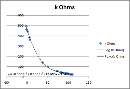

Step 4: What Is a Thermistor?
A thermistor is a resistor that changes resistance with the temperature. Using the techniques from the Voltage Divider to determine the Resistance, we can tell what temperature it is.
The problem is that I have some cheap thermistor in a casing from a 10 year old product. How was I suppose to create a function to go from a resistance to a temperature? Well, I have a Thermometer that it plugs into!
So I measured a lot. I copied the temperature down and then measured the resistance of the Thermistor. I placed it in the fridge, then I place it in warm water. Later I would grab room temperatures since I had time.
I supposed I could have read the Wikipedia plage can tried to guess the a and b factors, but I assumed I was using a non-linear, possible failing component that no longer matched it manufacturing specifications. Oh and I am lazy.
So I dumped all the values into Excel, and then graphed it.
I was originally worried that I had to remember the deep dark math of something like "least squared fit" when I discovered that Excell will do this for me!
Clearly I am missing gaps on the graph, but I got lots of good data around hot tub temperatures (100-105F).
While checking the room temperature ranges I noticed something, that almost makes my work worthless. The "Precise Temp" thermometer reported a 3-7 degree error between "indoor" and "outdoor" when the Thermistor was inches away! Now this might be because I mixed and matched thermistor between units, but I am betting it has more to due with quality of a 10 year old, $10 item&
Regardless of the "accuracy" of the temperature, I needed precision and multiple tests of the same range showed very close results over days. In the long run I will likely attach the thermistor to a pipe leading into the hot tub, so I will need an offset anyway.
So by getting Excel to display the equation, I then put it into the code, and so far it is "close."

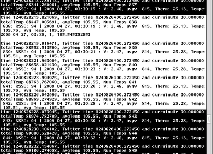

One of the things I needed was a good Range test. The X-CTU software from Digi has a "Range Test" built in, but it did notthing. I spent some time tryin gto figure out how to make it work. Actually this was as easier done than said. I did not really need the X-CTU test, just the "RX Signal Strength Indicator" (RSSI) value.
I looked in the xbee.pyTweet-A-Watt uses and right there, line 39: [code]self.rssi = p[3][/code]
Which means it is part of the Xbee return value! (xb.rssi in wattcher), so I modified a debug line for my hack:
print str(counter) +": RSSI: " + str(xb.rssi) + " | " + time.strftime("%Y %m %d, %H:%M")+ ", " + ": Voltage: " + str(CalcualtedVolts) + " avgv " + str(avgv) + " Thermistor: " + str(x) + " Temperature: " + str(Temperature)
Which produces a line like this:
373: RSSI: 82 | 2009 04 26, 11:18, : Voltage: 1.80100585938 avgv 593 Thermistor: 71.2276559865 Temperature: 78.6813444881
You can also see RSSI with processing, from Tom's Igoe's page. Though you will want to modify the packet length (at the top), as Processing complained about writing past the end of the packet buffer size. I believe you must be greater than 2 * expected packet length. Tom's code looks backwards for a previous packet which means if it misses the Ox7E packet indicator, it could run for while. Given that I am near the outer edge of measuring range, it can happen for a while. I set mine to 600 and it stopped giving me the "error, disabling serialEvent()" message.
Tom's code merely prints the latest setting, which is not all that useful for me. My debug line let's me track changes as Minion #1 wonder around.
Now we had a good way to measure, more than "hey dad we have a packet" it was time to try some home brew antenna ideas!

Step 7: Software
Starting with the Tweet-A-Wattsoftware I started hacking away at the python code. Mostly I needed to remove the Watts conversion, the history functions, and then I needed to add a number of divide by 0 protections (the Tweet-A-Watt assume packets will have data).
I then added the formula from Excel into the program and tested.
I set it to print every packet and I have lots of debug in the code to catch problems.
I tried to get the graphing portion working, but I gave up which brings me to:
Python Rant:
This is second time I have tried to do a major project in Python. I could not get all the libraries dependencies and base packages to work in under 20 hours in Windows, Windows 64, Ubuntu and Fedora. I finally had to build almost everything from scratch and even then some functions did not work. I tried 2.4, 2.5, 2.6 and various 3.X versions, and then versions of each library, which in turn had dependencies on other packages. While others may have rants against the language, I found merely installing, even using many of the "easy installers" to be daunting at best!
After I calculated the temperatures, I made a 1 degree adjustment, because I could not believe the hot tub was at 106F. I really do not believe it is at 105 either.
I then tweeked the reporting and twitter logic. Since I am not sure if I will get packets, or good packets, I chose to report the temp once an hour. I assume I will cut that back in a while.
Currently the script is running as a normal user. I will want to move it to a service eventually.
