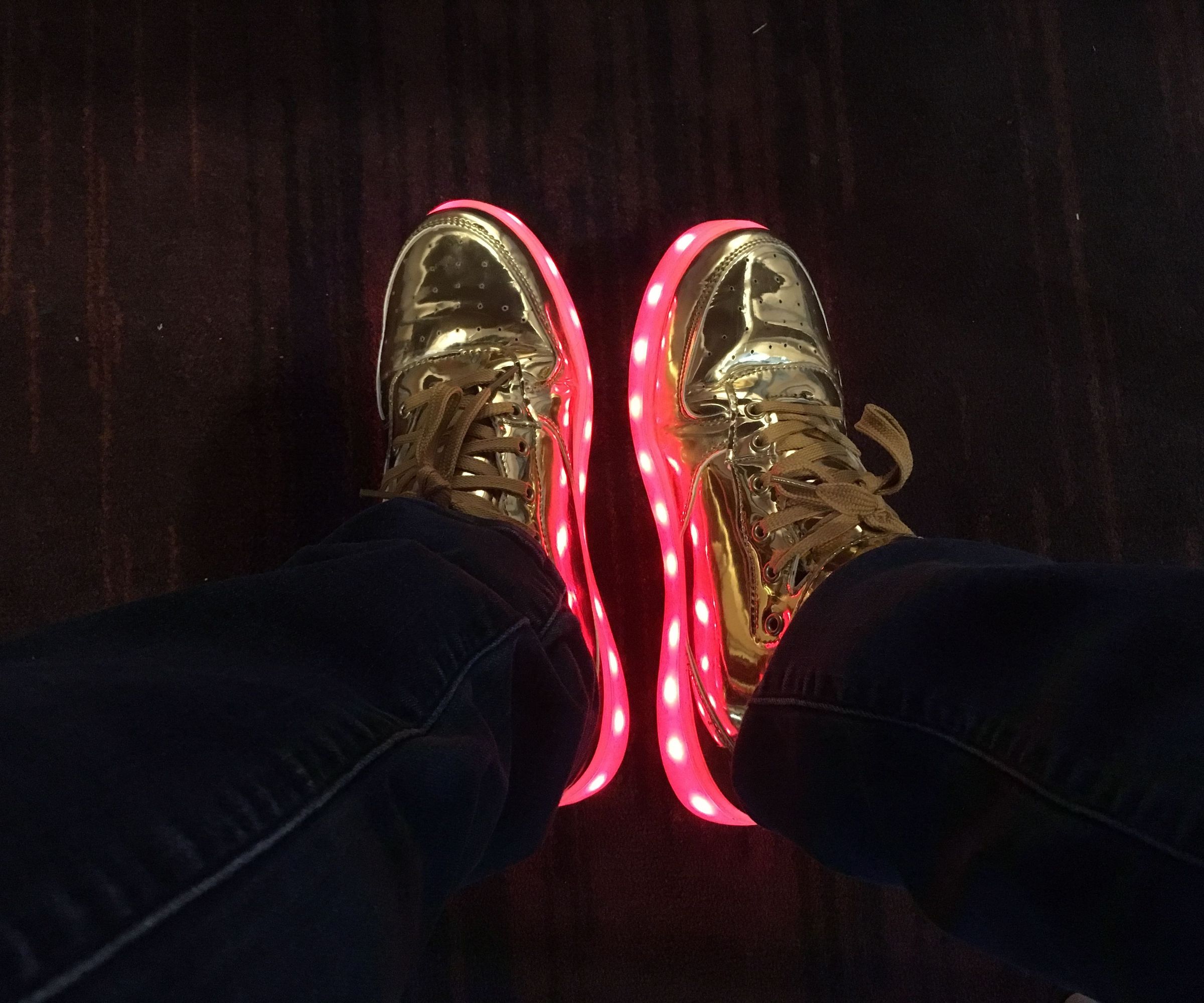

"Tweet my boots to make them change colour". This was a brilliant way to get out of making small talk when networking at conferences. I hacked my LED boots so anyone anywhere could change the colour by tweeting them. I bought the boots online. Originally, I pressed a button in the boot to change their colour. I removed the electronics module from the boots and replaced them with something I could control by wifi. Now when you tweet "#Cheerlights" and a colour, they change to that colour.

Step 1: Remove the Original Electronics
Note: Boots may be different - my photos may not match your experience.
- Remove the insole of the boot and carefully slice the fabric inner to expose the sealed battery pack.
- Unclip the two connectors - the micro USB charger socket and the LEDs.
- Check that the LEDs are RGB LEDs inside (and not neopixels). RGB LEDs have four wires going to them - one for red, green, blue and positive. (Neopixels will have three - data in, positive and ground). See Adafruit's uberguide for a great description of the difference between RGB LEDs and neopixels https://learn.adafruit.com/adafruit-neopixel-uberguide/overview.
- Check the voltage of the battery. The 3.7V batteries I removed were replaced with ones of the same voltage.

I 3D-printed a case for the Feather Huzzah and the extra circuit. However, to make it fit inside the shoes, this had to be very thin and broke after my first few hours walking. Next time, I would put a hardboard layer under the electronics, between the ridges on the inside of the sole.
- Make sure the electronics and Feather Huzzah fit into the cavity left in the insole. I had to remove some of the boot support ribs.
- Insert something robust (non-metalic) and slim into the sole of the shoe, to protect the electronics from damage from underneath.
- Make an extra "insole" to place over the electronics, to protect it and your foot.
- Attach all the cables, battery charger etc to everything, and see if it all fits. If so cover the electronics with the extra insole, replace the original insole and try your foot in it.
- The switch and the female USB B socket should be accessible even with your foot inside. However, as I said in the previous step, I do not recommend charging your boots with your feet still inside them.
