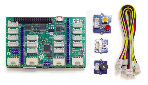

In this instructable, I will explain how to make a very simple project with DragonBoard 410C + Grove Starter Kit for 410C.
To run this tutorial you'll need:
Qualcomm DragonBoard 710C Board.
Compatible Power Supply for the board.
PC with Linux Ubuntu 16.04 (I used this distribution in this tutorial).
USB Mouse and Keyboard.Monitor with HDMI Interface
HDMI Cable
To run this tutorial, you need a DragonBoard 410C with Linux Linaro-Alip. To install it, refer to these tutorials, available in Portuguese at Embarcados and in English in Instructables. To set everything for the Grove Starter Kit for 410C, refer to this tutorial available in Instructables.

~Step 7: Mounting the Hardware
Connect the Button Grove Board to connector D4.
Connect the Buzzer Grove Board to connector D5.
Connect the Led Grove Board to connector D3 and Connect an LED to D1 connector at this board.
