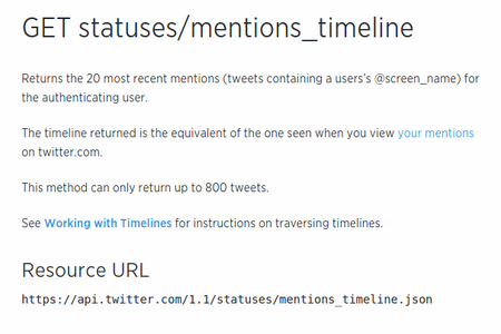

If you check out the Twitter API, you can see that there are requests we can call which will return different types of information. Because we want to use the mentions of our account, we only really care about the GET statuses/mentions right now (This is the page that was opened). In order for this to work, we need to use a PHP file that will be the server-side of this project. Be sure to download and save the "TwitterAPIExchange.php" file. I would suggest naming the file "getmention.php", but it's really up to you.

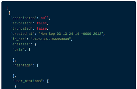

- $url = "https://api.twitter.com/1.1/statuses/mentions_timeline.json"; and the line below it send a "GET" request to Twitter, then Twitter sends us the mentions from the user. The 2 lines below "GET" are error checking, and you can change these as you want.
- The last part section is assigning $time to the most recent mention, and then sends it to our JavaScript file.

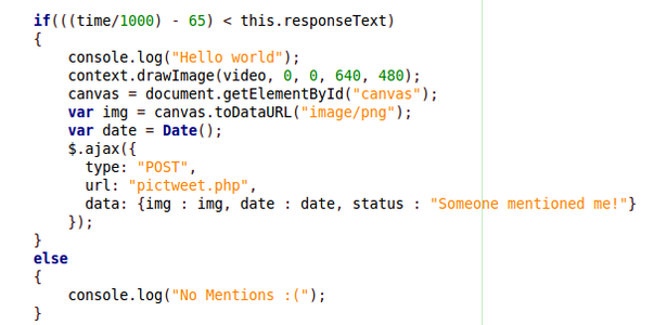

If our account has been mentioned, we want to send a Tweet. Luckily, this is the easiest part of the program. We can use the code (or make a new function if you so desire) that updates our Twitter account.
if(((time/1000) - 65) < this.responseText)
{ console.log("Hello world"); context.drawImage(video, 0, 0, 640, 480); canvas = document.getElementById("canvas"); var img = canvas.toDataURL("image/png"); var date = Date(); $.ajax({ type: "POST", url: "pictweet.php", data: {img : img, date : date} }); }
This just draws a new image from the canvas, then call the pictweet.php file we created in the previous instructable.
While the program is running, we can take pictures with the "snap" button to send a picture to Twitter, and if our account gets mentioned, it will take a picture with the same webcam (within 65 seconds) and then upload to Twitter, just like the "snap" button Tweet.
