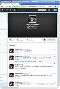

- Periodically tweets the status of your smoker so you can monitor your cook from anywhere in the world. Requires an internet connection (double duh). If you need something to put yourself to sleep you can follow my smoker's twitter account.

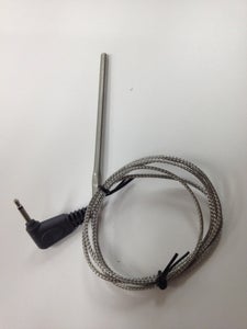

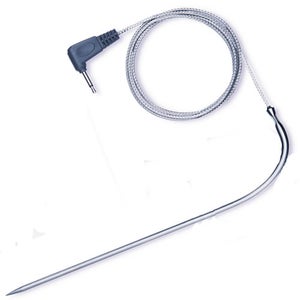

| Maverick ET-73 probes | You want at least two probes, one for the pit temperature and one for the food. The pit probe looks different from the food probe so look at the pictures above to get one of each. Be sure to get ET-73 probes, not ET-732 probes. They have slightly different plugs and are not compatible. | 2+, max of 6 | Search Amazon and Ebay | $10-15 each |

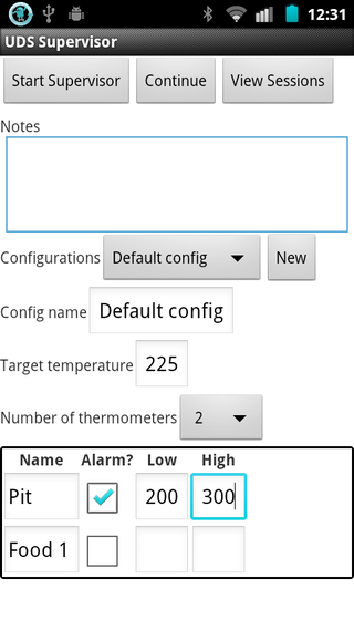

Main Screen
Opening the Supervisor brings up the main screen. This is where you set the options for your smoker and start a session for controlling your smoker.
Start Supervisor - Press this button when you are ready to start a new session to control the temperature of your smoker.
Continue - This button will continue the previous Supervisor session. Use this if you stop a session to change a value (like the target temperature).
View Session - This button will show a list of all the smoker sessions you have started. See the View Sessions section for more.
Configurations - This is a drop-down box that allows you to select one of your configurations. The Supervisor is installed with a single configuration named "Default Config".
New - This will create a new configuration.
Config name - Name of the current configuration.
Number of Thermometers - The number of thermometers for this configuration.
Thermometer list - Each thermometer can be given a name here. Note: the first thermometer is always used as the pit thermometer regardless of its name. Turn on the checkbox if you want this thermometer to fire off an alarm if the temperature falls outside a range.

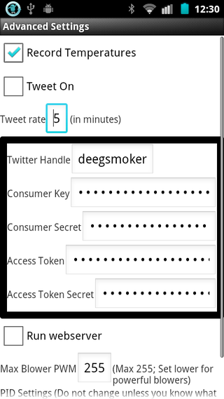

Main Settings
Access this screen from the Menu button on the Main screen. This allows the user to change lesser-used settings.
Record Temperatures - If on, then the temperatures will be saved to the database and can be charted later. If off, the session can not be viewed.
Tweet On - If checked, then peridically tweet the status of the smoker.
Tweet Rate - Specifies (in minutes) how often to tweet the status.
Twitter info - Twitter handle and passwords necessary for tweeting the status.
Run webserver - If on, then starting a session will start the web server to handle HTML requests.
Max Blower PWM - Set this value lower for larger and more powerful blowers.
PID settings - These are the PID settings for the PID Algorithm used by the Supervisor. Change these only if you know how to tune a PID controller.

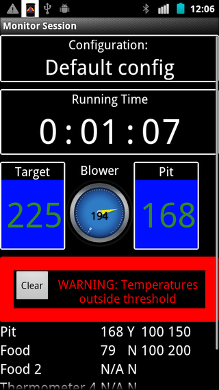

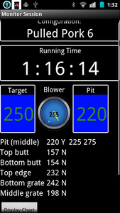

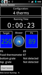

Monitor Session Screen
This screen is displayed when the Supervisor is monitoring the smoker and controlling the blower. It displays the target temperature, the thermometers, and the blower speed.

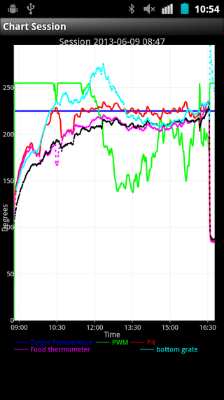

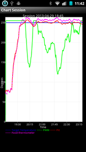

Chart Session - Press to view a running chart of the current session.
To stop the current session, press the menu button and select "Stop Monitor".
Example of a temperature error:
Chart of smoking session

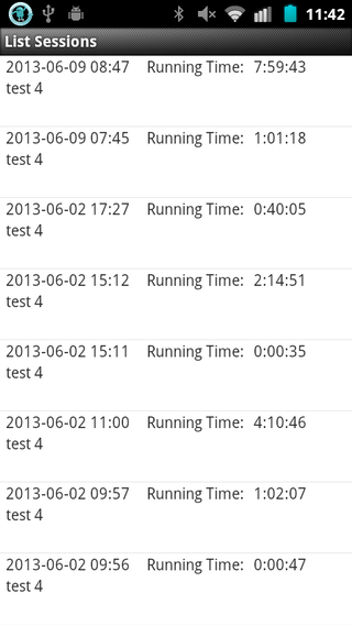

List of previous Sessions
This lists previous smoker sessions. Click a session to see the chart. Hold-click to delete a session.

- A chart of the cook will be attached to every 5 tweets (only if session is recording the data).
- The Twitter Monitor will show the most recent chart.
