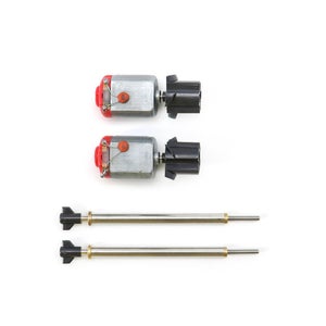

The motor/shaft set : motor and shaft set

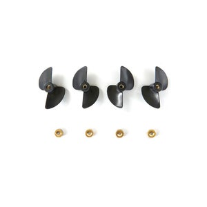

The propellers : propellers and nuts

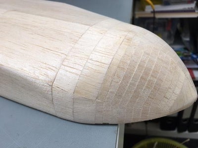

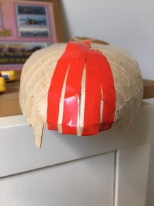

When done cut off excess balsa and sand carefully . Now it's time to cover the bow ... This is a bit tricky and you'll need some patience . I tried covering using 15mm strips made of 1mm balsa but it didn't went very well , pins were needed to keep the steps in place . 5mm strips are much easier and needed no pins , the glue keeps them in place so you can continue working ... till you've had enough . Time for a break :-)
When almost done we add 2 1,5mm balsa triangles , use tape to secure them while the glue dries . When dry sand with 80 grade and 180 grade sandpaper , take care when using the 80 , the sheeting is only 1,5mm thick .

Both motors are wired to run CCW , see picture . Make sure to pick the CCW props , in the set you'll find 2 CCW and 2CW props . If you like you can configure 1CW and 1CCW , just select the proper propeller .

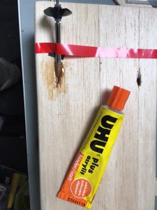

Now it's time to install motors , shafts and props . Take your time for this job and make sure motors and shafts are aligned properly . When motors and shafts are well aligned power loss is minimal . Motors are kept in place by 3M "GoPro_fixing_stuff" ( very strong double-faced tape ) . (Note : because the motors get warm and cause vibrations I added some "construction Glue" to be on the safe side ...)They are mounted on 2,5mm balsa and 6mm depron . The shaft is glued into the hull with UHU acrylit ( aka Pattex Stabilit Express ) . When both shafts are installed add some more acrylit , it can be sanded afterwards . When done add super light filler to the hull and let dry . Sand and you're done !
