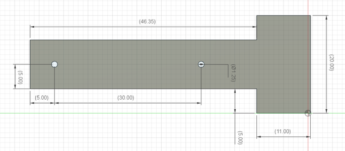

Step 3: Laser Cut Your Body Parts
This step is unfortunately, more vague. Either you know how to use a laser cutter and understand the process of transferring a .dwg file to be cut, or you will have to find someone else who has practice with such files. Once you have your parts cut, the bodywork should pop right out of the acrylic plate, with the occasional snap.

All that is left now is to assemble the legs. The center drive legs, we will leave alone for now. The four outer legs on the corners of the robot, you can add very easily by either gluing them to the side of the C3 support with the massive faces against each other, or, you can skip the glue and instead take your 22AWG wire / unfolded paperclips and thread these wires through the two tiny holes that are on the outer four C3 supports. All that matters here is that the legs all point the same direction, and they are immobile, only serving to prob the robot off the ground.
Step 8: Assembling the Servo Powered Legs
This is the most difficult step in the assembly. If you used 22AWG wire to thread all the other parts together up to this point, you will have no problems. But for the axle / cranks that connect the servo head and the free axle slot from the C2 center support, you will need the paperclips. This is because in my testing, using the 22AWG wire lead to a barely function and self destructive design as this wire is so flimsy and easy to deform that the force that the servos try to deliver to the legs instead is wasted as the supports between the center leg and the servo motor twist and bend in real time. Paperclips on the other hand, are generally made of much stiffer and stronger materials, and as such are much better suited to being the connection between the motor and the leg.
Start by attaching any of the "heads" that should have came with your servo motors and screwing them into the servos themselves. Each head should have a row/rows of tiny holes in each side, which just perfectly match up with the diameter of the 22AWG and Paperclip wires. Start by cutting a very short piece of paperclip, make sure it is as straight as possible, then bend a tiny hook near the end. You will be threading this tiny hook through the holes in the servo head slot. MAKE SURE YOU COUNT HOW MANY HOLES YOU OFFSET FROM THE CENTER. This is important not only for maintaining the symmetry of the robot, but also because you will need the exact distance between this first clip that connects to the motor, and the second clip that will be longer and used only as a free rotating support will need to have a bent portion in the center that is THE EXACT same length as the distance from the servo head screw to the hole where the hook is attached. The hook will almost immediately fall out, so the best thing you can do is cut a piece of scotch tape in half to reduce the width, then as soon as the hooked axle is through the servo head, lock it into place against the servo head by taping it down.
Now for the free axle. Unlike the first, shorter, hooked axle, this axle is more of a crank then a straight cylinder. Your goal is to unbend a paper clip to the point where it is straight as possible, then make two 90 degree angle bends spaced at the distance we just found before, but also have those angles leading to the wire still remaining parallel to itself, just offset from the center. This should leave you with a paperclip that is way too straight and long, but that is OK as all we are using this axle for is to thread into the top slot of the C2 support. If you assemble this part correctly, your second axle paperclip should look like a camshaft. You can always cut extra length off if you need to minimize distance between the robot and the legs. Both slots in each leg should now be possible to fill. You will know if you threaded your custom wires correctly if you try to cycle through the leg motion and the leg almost appears looked in place but it really is only not rotating, but still moving. It should almost look like a horse galloping with its legs cycling as it moves.
If you want even more support, you can cut a very thin, 1x2" piece of cardboard for both sides, and thread so it lays flat over the top slot of both C3 supports. Then, you can poke a hole in this now flattened cardboard in line with the center of the servo head below it, before finally pushing the free crank axle through this hole and into the center C2 support's top slot.
