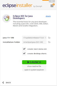

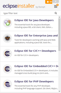

Step 2: Launch the Eclipse Installer
You should see something like this, select the Eclipse IDE for Java developer.

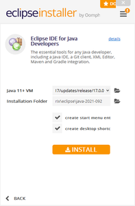

Step 3: Install the Eclipse IDE
Click INSTALL and then accept the End-User License Agreement when the window pop up.
Step 4: Launch Eclipse
After the installation process completes, click LAUNCH.

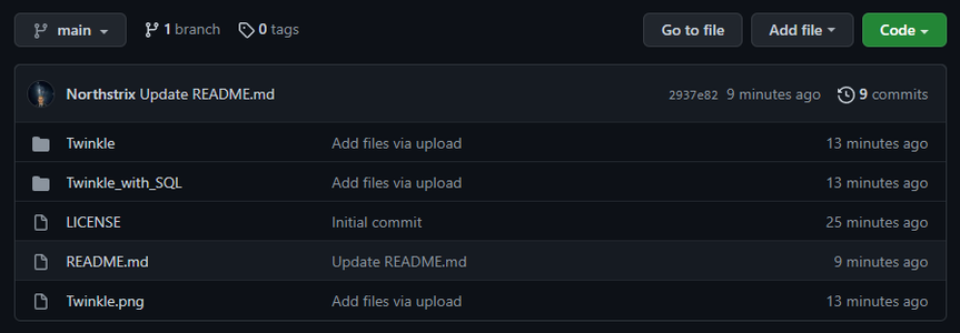

Step 6: Download Twinkle
You can download Twinkle here https://github.com/Northstrix/Twinkle

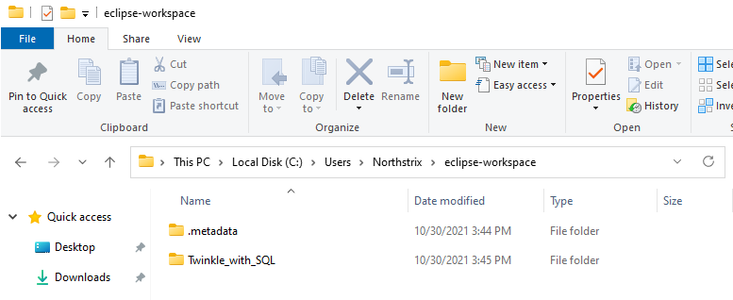

Step 7: Extract Twinkle Into the Workspace
Choose the version of Twinkle you need and extract it into the workspace.

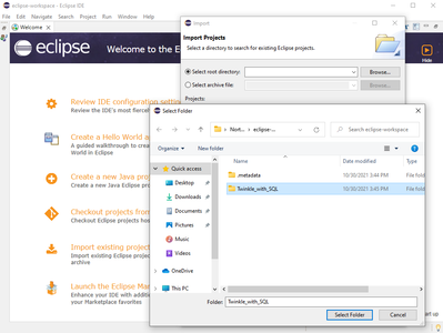

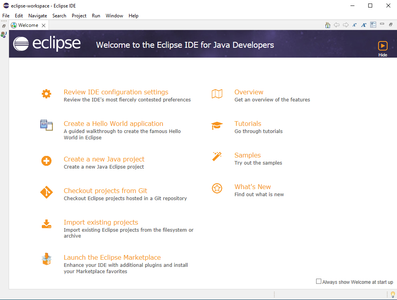

Step 8: Launch Eclipse IDE for Java Developers
Step 9: Import Twinkle
To do so, click Import existing projects. Then in the Select root directory line click Browse. Navigate to the workspace and select the folder with Twinkle.

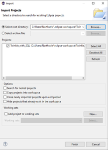

Step 10: Make Sure the Import Tab Looks Like This
If you did everything correctly, the Import tab should look very similar to the one in the photo.
Press Finish.

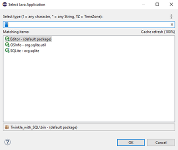

Step 17: Select the Editor Class to Run (Twinkle_with_SQL Only)
If you've chosen Twinkle, then skip this step
if you've chosen Twinkle_with_SQL, then select the Editor class and press OK.

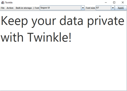

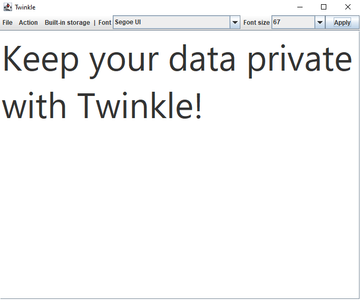

Step 18: Write a Note
It's time to add the first record.
You can change the font and the font size in the designated combo boxes.
Press Apply to apply the new font and the font size.

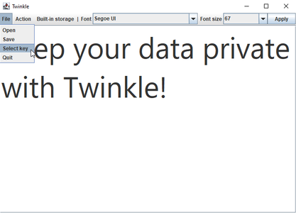

Step 20: Click Select Key
To select the key, click File -> Select key

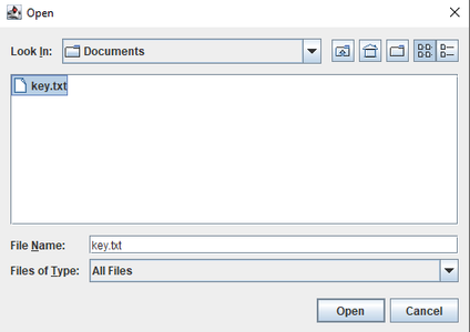

Step 21: Locate Your Key
In the pop-up window, locate the key that you've generated, click on it, and then press Open.
You need to load the key every time you're opening the program.

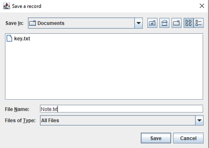

Step 22: Save Record
To save record click File -> Save. After that, navigate to the folder where you want to save your record, enter the name of the record, and press Save.
The extension of the file that contains the note is irrelevant.
Step 23: Content of a Note
That is how Keep your data private with Twinkle! looks for someone without a key.

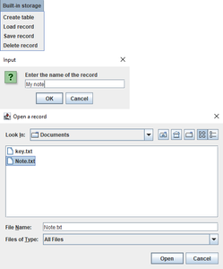

Step 25: Add Record to the Database
To add a record to the database save it first.
Then click Built-in storage -> Save record. Name your record as you wish and press OK. Now, navigate to the saved record, select it, and press Open.
In case of success, you will get a corresponding message.
Step 26: Load Record
To load the record, click Built-in storage -> Load record.
In the pop-up window select the record that you want to load and press Select.
