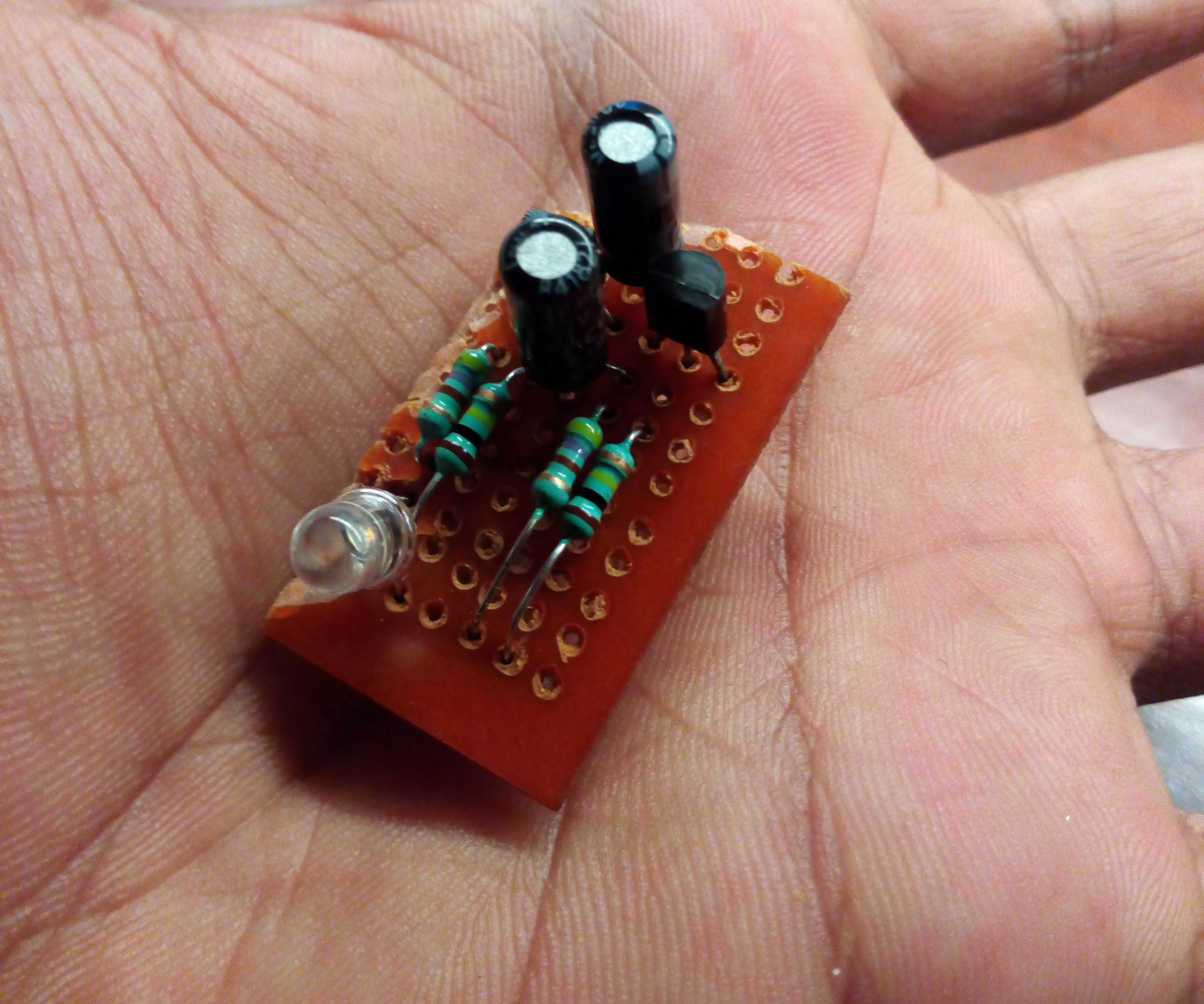

Step 5: The Electronics
Don't be afraid, I understand how much trouble you must have went through to get this far but don't afraid of the electronics even if you have no experience. You can learn how to make it in my other project but here I have just used 100u capacitors instead of the smaller 22u ones and a 10k resistor in place of one of the 470ohm ones. The reason for this is to reduce the rate at which the led blinks to make it a little more 'soothing' to look at.
How to make it: https://www.instructables.com/id/The-Simple-Flasher...
To put it on a perforated board I just arranged them in the same way as I did for the bread board and soldered them in the same way as connected on the breadboard.
A tip given to me by 'klauson' to help defuse the light more is to scrape the led with sand paper.
