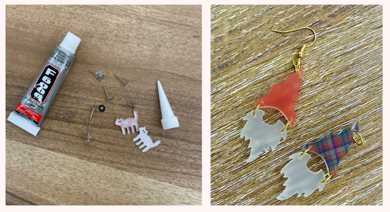

Step 5: Assembly
Use pliers to attach C-rings to connect the wooden and acrylic layers.
Insert the earring hooks through the pre-drilled holes.
Step 6: Final Touches
Inspect the earrings for any imperfections.
Smooth any rough edges with sandpaper and apply additional paint if necessary.
