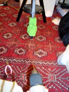

Something stable to attach the wire to (I used a stool leg. Pick something that you can slide the cloth off of!)
Step 2: Attach Wire
Wrap your wash cloth around the stool leg.
Take a long length of wire(I used about 4 feet) and twist it once around cloth to get everything to stay in place.
Place the two ends of wire together and bend over to form a hook.
Place hook in the mouth of the drill and close the drill around the wire firmly. (My drill clicks when I can't tighten it any further.)
Step 3: Twisting Time
Firmly hold your drill and turn it on so that it drills slowly.
The wire will begin to shorten and you will feel it pulling you forward a bit. If you give the wire slack it will twist loosely, if you hang on tight it will twist tightly.
The wire will begin to warm up due to friction. Eventually the friction and the tightness of the wire will snap the wire off by the washcloth. If you don't want it to snap off let the wire rest when it gets warm to cool it, then twist more. Or stop where you are and slide it off the stool leg.
