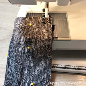

Fold the top up and match the end. Pin down both sides as far as you can without interfering with the horizontal fabric.

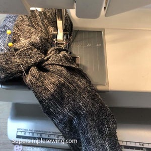

Step 4: Sew
sew at 1/2" seam allowance using a zigzag stitch if working with knits. woven fabric can use a straight stitch.
Sew until you reach the horizontal fabric. Be sure not to catch it. if you are sewing with a woven fabric leave enough space from the end that the horizontal fabric moves freely.
Step 5: Repeat for Second Side
Repeat on the opposite side.

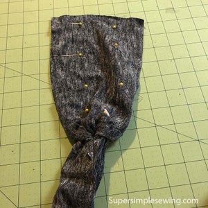

Step 6: Pin Together Remaining Side

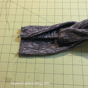

This is what it will look like. The free ends should be facing up. You should be looking at the right side of the fabric.
Bring Right sides together and pin.
Pin down as far as you can. Don't interfere with the previously sewn piece.

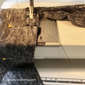

Step 7: Sew Second Side of Headband
Sew a 1/2" seam as far as you can.
Repeat for the last side.

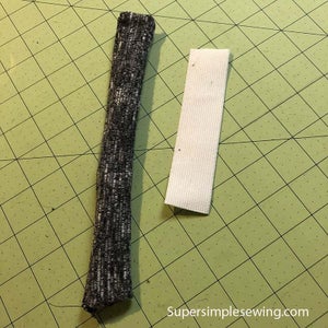

Step 9: Fold Small Rectangle
Fold small rectangle in half lengthwise. Pin together.
Step 10: Sew
Sew down the long side.
Step 11: Turn Right Side Out
Turn Tube right side out.

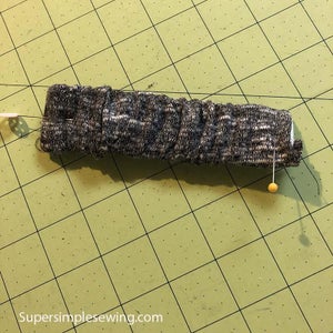

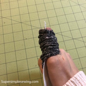

Step 12: Run Elastic Through Tube
Work the elastic inside the tube. With this light weight knit I feed it on my thumb then I was able to pass the elastic through along my thumb. there is always the trade and true feeding a safety pin through method.
Step 13: Tack the Ends
This is what it should look like. There should be extra fabric covering the elastic. ( the wrinkles you are seeing)

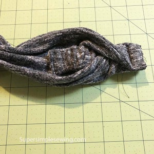

Step 15: Turn Out Elastic
Flip right side out.

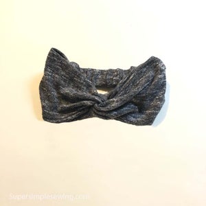

Step 17: Done!
Turn it right side out and you are done!
