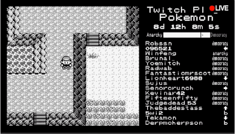

Inspired by the popular Twitch Plays Pokemon (where viewers of a stream sent commands for the game's character to follow) and various delivery robots on the market, we wanted to create a entertainment in the form of a delivery bot the viewers are challenged to control. If you've never heard of Twitch, it is a live broadcast in which people can watch and chat in real time!

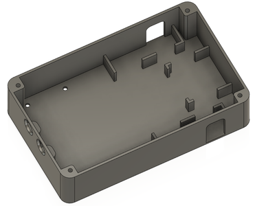

Step 2: Modeling Chassis
First we needed a chassis to hold our components—the microcontroller, motors, motor driver, distance sensor, and battery pack.
To decide on the area, we placed all the components together and estimated the space needed, with some tolerance. We decided an area of 20 cm by 12.5 cm, would be enough so we started with that as a base. We also needed at least 42.5 cm of height from floor to top to allow components to fit. Walls were 0.25 cm thick.
Then we added features to the chassis to accommodate for our components. To hold the motor and driver in place, we added frames inside of the chassis to hold them in place. In addition, we had holes in the side so the motor axles could poke out. We also made a mount for the distance sensor. The height is necessary for the distance sensor to properly function, as it shoots sound out in a 30 degree cone to detect obstacles, and can bounce off the ground.
Finally, we needed a way to hold the chassis housing and container portions of the bot together. At first we wanted to design a snap-fit, but we found it easier to do holes for nuts and screws. These were also used on the bottom of the chassis for the bearing ball casters.

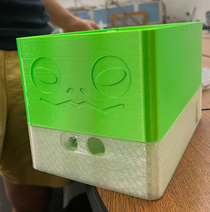

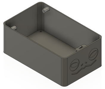

Step 3: Modeling the Container
Next we designed the container and lid, starting with the container.
The container is fairly simple as it follows the same profile as the chassis below it.
A lot of time was spent adjusting details on the hinge and how it would print and function; but ultimately, we settled for a flap lid instead. For this design, we had cylindrical extrusions on either side of the interior of the container for the lid to snap onto.
We also put a toad face on the container, alluding to the project's name of TOADS, and adding aesthetic flavor!

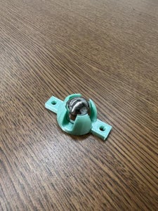

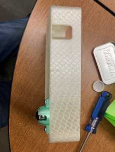

Step 5: Modeling the Ball Transfer Unit

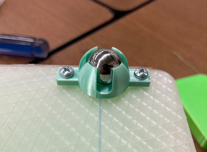

A bearing ball caster is a type of wheel that uses a bearing ball to roll in any direction. We thought this would be great for giving our robot stability when moving while also giving it a full range of motion. In comparison to swivel caster wheels you can buy, this does not interfere with movement when the caster swivels back and forth, and the ball caster can be adjusted to fit the height of our wheels in the final product.'
With this design, we designed it around the 3/4" bearing ball, and we did several different sizes to print to test what would fit perfecty. We added a lot of fillets to add stability to the caster when it is bent open by the bearing ball.

Step 8: Bearing Ball Caster Print
Again, we printed multiple sizes to test with the bearing balls. Upon testing, 3 out of 5 of the different sizes snapped or did not fit well. 2 of them did, which were the middle in the range of sizes, and we found that they rolled as expected.
Step 9: Chassis, Container, Lid Print
The printing of all these containers went well, and we had no problems for the most part. The face on the front of the container actually came out very clearly, which was a nice surprise. For the lid we went on without the snap fit as it was not important to the overall function.

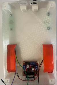

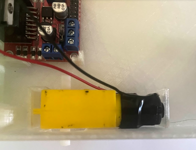

Step 11: Motor and Motor Driver Placement
Then we wanted to assemble the whole thing, starting with the motors and motor driver.

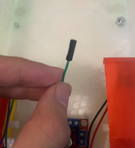

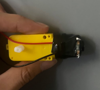

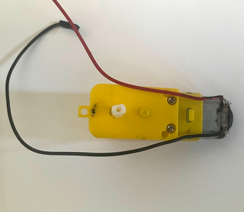

The first thing we did with the motors was was to solder the wire leads to the motors themselves, as the motors came with no secure way to fasten them together. You could also possibly use electrical tape, which is also important to wrap around the leads so that they don't move and break the fragile solder.
We placed the motor driver and motors into the chassis. While the motor driver fit as expected, we found that we needed to break off a piece of the wall and make some adjustment to the motors by sanding down protrusions, to fit it in. After, we taped down the motors inside the mounts with duct tape.

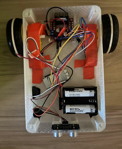

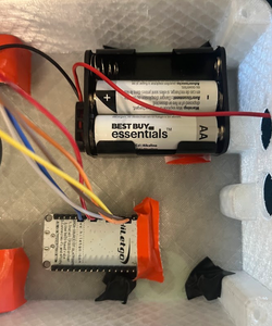

With the battery holder and ESP8266, we didn't really need to hold them down all that well. The motors of course needed to be held down because their movement depended on it, but the ESP and battery didn't move all that much and just needed light securing, which was done with- you guessed it- more duct tape! The HC-SR04 distance sensor mounted as expected on the front, with some sanding on the holes.
One thing to note is that we covered any screws and nuts with electrical tape to make sure there was no unintended conduction. As you can see in the picture, we also did the wiring, which will be elaborated on in the next step.
Step 13: Create Circuit
The wiring part of this project was tricky to figure out for first time Arduino users... first time circuit creators in general, really. Some of it is straightforward, some of it is based on code.
The most important thing in the wiring is the power, because you need it to turn the thing on in the first place, and because it can easily fry your components.
The idea here is that we will power the L298n directly from the battery, then power the ESP from the L298n, then the distance sensor from the ESP.
The battery positive should go to the L298n (if the black rectangle, the jumper, is on behind the 12V, it currently doesn't take more than 12V but can take more than 5V). We did not as to not cause any accidents to begin with.
As you can see, we connect Vin to the 5V on the L298n- the Vin pin can take 5V and regulates it down to the 3V that the ESP uses. The 3V3 outputs 3V, and connects to the HC-SR04 which can run on 3V if you have the right kind.
All components should be connected to common GND to complete the circuit. All GND pins on a board are connected together. So, black battery lead to the GND of the L298n, L298n GND to the ESP8266 GND, ESP8266 GND to the distance sensor GND.
Finally, put in your batteries, and when you're ready to turn it on, insert the positive lead of the battery into the L298n 12V. If you're not going to use it, take a battery out of the holder so no accidents can happen.
Now for the other pins, a lot of it is defined in the code itself. The motors should however, go to the OUTs on the L298n, one to each side (1,2 & 3,4). Generally the ENA, ENB, IN1-4 should go to an D pin on the ESP. Which one, is defined in the code. Echo and Trig on the distance sensor is the same way.
