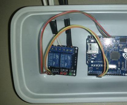

- 1x Dual Channel Relay (5v)
- 1x Ethernet Cabble
- Jumpercables
I stored my circuit within an topware, since it is going to be in my bedroom and I don't want to take any risks. =)
