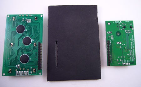

We need something that will support the LCD screen and hold it in the frame. We used a ridigid piece of black plastic, but foam core might work too.
Use the existing picture backing to mark the material. Cut out a replacement using a cutting blade. The edges don't need to be neat because the frame will cover them.

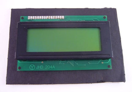

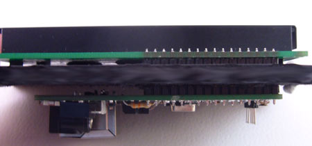

Center the LCD on the material and mark the location where the pin header should go through and mate with the #twatch PCB. Cut out a small strip, cut carefully so that the LCD screen is held securely in the center of the frame.
Mate the LCD to the #twatch through the hole. Put the electronics/backing sandwich into the picture frame.

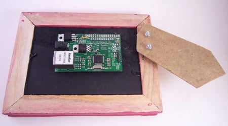

Step 2: Move the Stand
Our picture frame had a stand with a hinge screwed into the existing backing. We removed it, and relocated it to the side of the frame, where it's out of the way of the #twatch LCD backpack and cables.

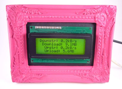

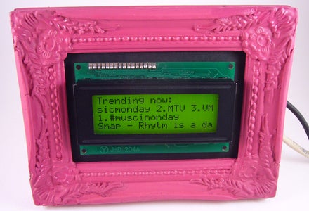

Step 3: Scroll Twitter
Plug in the network cable and power to scroll the latest trending topics and tweets from Twitter.
